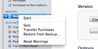

I don't get that option. Not sure what I may have borked so that this isn't available but hence my initial question. (see attached)

Ok - I may be confused about this bit - in hindsight I may have just been syncing with a backup which was dated back to August 2010. I'm still befuddled that it will never show any syncs more recent than that when I've been sync'ing regularly...
And thanks for the responses btw!

Ok - I did this and then when I right-clicked on my iPhone in iTunes there was no option to backup... which brings me back full circle to the question: how do I back up my iPhone 4!?
Have I borked something which has resulted in this no longer being an option?
See my last post for a screenshot of my options before deleting all backups and the one attached to this post for my options now.
Ok - I tried a different google search term and found the fix.
I had to open terminal and type the following:
"defaults write com.apple.iTunes DeviceBackupsDisabled -bool false"
Now the backup option is back when I right-click on my iPhone - phew!
Ya that was my next question I was going to ask you, if you disabled backups at somepoint. Glad you found the answer!
