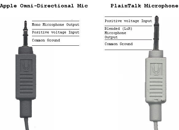

which model? if it needs phantom power, it won't work, because to get that you need a longer plug. look at this image of a plaintalk mic (which is long enough to grab phantom), from here:

so you get noise floor, but no signal. sounds like the mic isn't receiving power. how is it powered?
the thing that drives me nuts, and has for several years, is 1) that apple uses a non-standard connector, and 2) that they don't properly describe it.
with the advent of the combo analog/optical port, i don't know if the plaintalk argument still applies. but if it does, the problem is quite simply that you bought the wrong mic. your mic has a standard mini plug and is looking for phantom power, which it can't find because of the non-standard audio in port.
