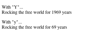

That is really strange.
When I use "Y" I get...
Rocking the free world for 1969 years
And when I use "y" I get...
Rocking the free world for 69 years

Make sure you aren't getting any warning in your log about timezone settings like:
Warning: date(): It is not safe to rely on the system's timezone settings. You are *required* to use the date.timezone setting or the date_default_timezone_set() function. In case you used any of those methods and you are still getting this warning, you most likely misspelled the timezone identifier
