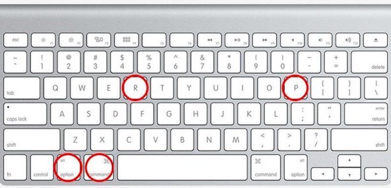

For a start THERE IS NO PRAM resetting in cMPs . .
. . . . .. THERE IS however NVRAM resetting ( = Non Volatile Ram )
The way to RESET NVRAM is to hold DOWN the keys shown below. .
. . . 3 ~ 4 times CONSECUTIVELY without letting go of the keys until the LAST CHIME.
Reactions: danallen
SIGNIFICANT UPDATE
The cMP is running Catalina with a Radeon 5770. Pretty much narrows problem to the R9 280x I had been running.
This happened after resetting the nvram with a four chime cycle (hold down cmd option p r starting immediately after hitting the power button to start the machine. The reset might be a red herring, I am not positive I had tried booting this installation with the Radeon 5770 previously.
