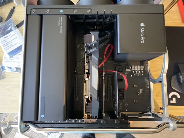

I take it you are on a 2019? I've looked around...a lot. Does Apple support bootcamp on your machine?
I looked at AMD's site and found Radeon Pro W5700 drivers. They like to group item in a thousand number capacity. It's missing the "x", but maybe it may work?

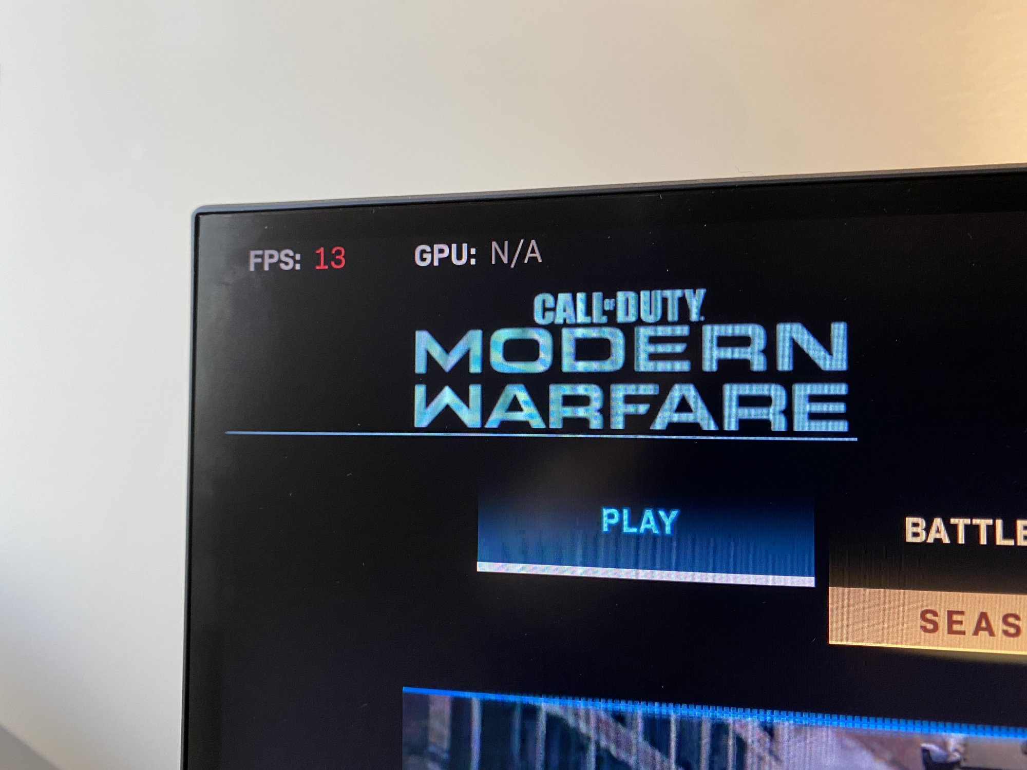

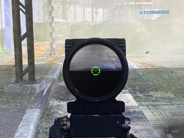

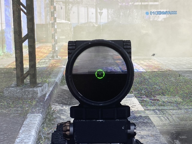

Installed the new drivers, following all the instructions (DDU to remove everything, etc.), and it runs like crap. No rainbow effect, but the frame rate is appalling.
Sparkles all over the windows desktop over HDMI at 4K as well. Desktop is fine over DP and Thunderbolt.
