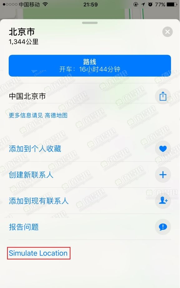

This was a little known capability, but you used to be able to change the Apple Maps plist setting for __internal__PlaceCardLocationSimulation to true, in com.apple.Maps.plist. This would reveal a button in Apple Maps to simulate you GPS for all apps to any location on Earth to you choosing. This did not require a jailbreak. Google it to learn more.
This was super useful to avoid geo-restrictions on apps like the blackouts in MLB At Bat. Sadly, this seems to have been removed in iOS 11. Does anyone know if there is a workaround or another plist setting? Does anyone know how to find these private/internal plist settings for iOS? Maybe there is an alternate in iOS 11.

I can't find an English picture of it, but it was as easy as setting a pin in Maps and tapping the Simulate Location button pictured below:

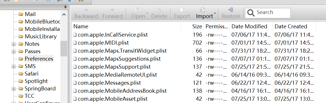

I have backuped my iPhone just now but there is no com.apple.Maps.plist in the list. It seems that Apple removed it in iOS 11. It might be available by modifying the other three files, but I didn't try as there is no spare device for me.

Thanks. What app are you using to look through the backup? I had used iBackupBot in the past, but it no longer works.
It's iBackupBot for Win Ver 5.4.4 and it works properly on my device. Did you disable encrypted backup when backing up?
Yep, disabled. iBackupBot has seemed pretty clunky on Mac for a while.
Of those three, I would guess MapsSupport.plist is the most likely candidate to re-add the setting (assuming no other Maps plist exists in some other directory).
