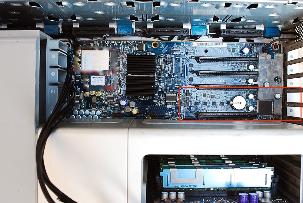

Not sure I understand your problem.
The 2008 MacPro3,1 is designed to accept a double wide GPU in slot #1 and still allow the unimpeded use of slot#2 as show in this picture.
Am I missing something?
In the past I've used a couple of different double wide GPU's in slot #1 and had my Kingston HyperX PCIe card in slot #2 with no problems.
Thank you for your post. The thing is I have a Sonnet Tempo in slot #1. I believe I has to be installed there, but I will see what happens benchmark-wise if I switch places of it and the GPU.

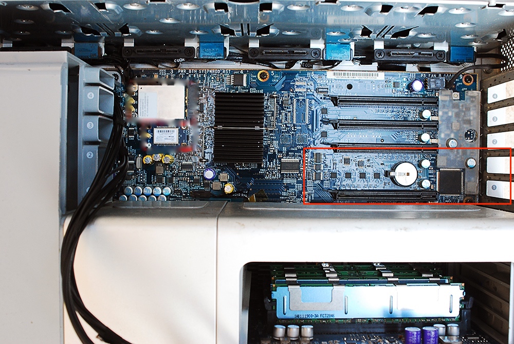

I've now tested both cards in both slots 1 and 2. Amorphous Disk Mark show that the SSDs on the Tempo card perform equally well regardless of whether the Tempo is in slot 1 or 2. But if I put the Tempo in slot 2 the boot will be considerably slower, 30+ seconds to 15-17 seconds in slot 1. Plus all fans in the computer rev like mad during boot if I have the Tempo in slot 2 and the 5870 in slot 1. Ideally I'd therefore like to keep the Tempo (which holds OS X and the home folder) in slot 1. So the hunt is still on for a slim GPU for slot 2.
Not sure there is one.
A GT120 would fit, but is (much) slower than a 5870.
A Firepro W7000 fits, but does not provide boot screen, etc.
