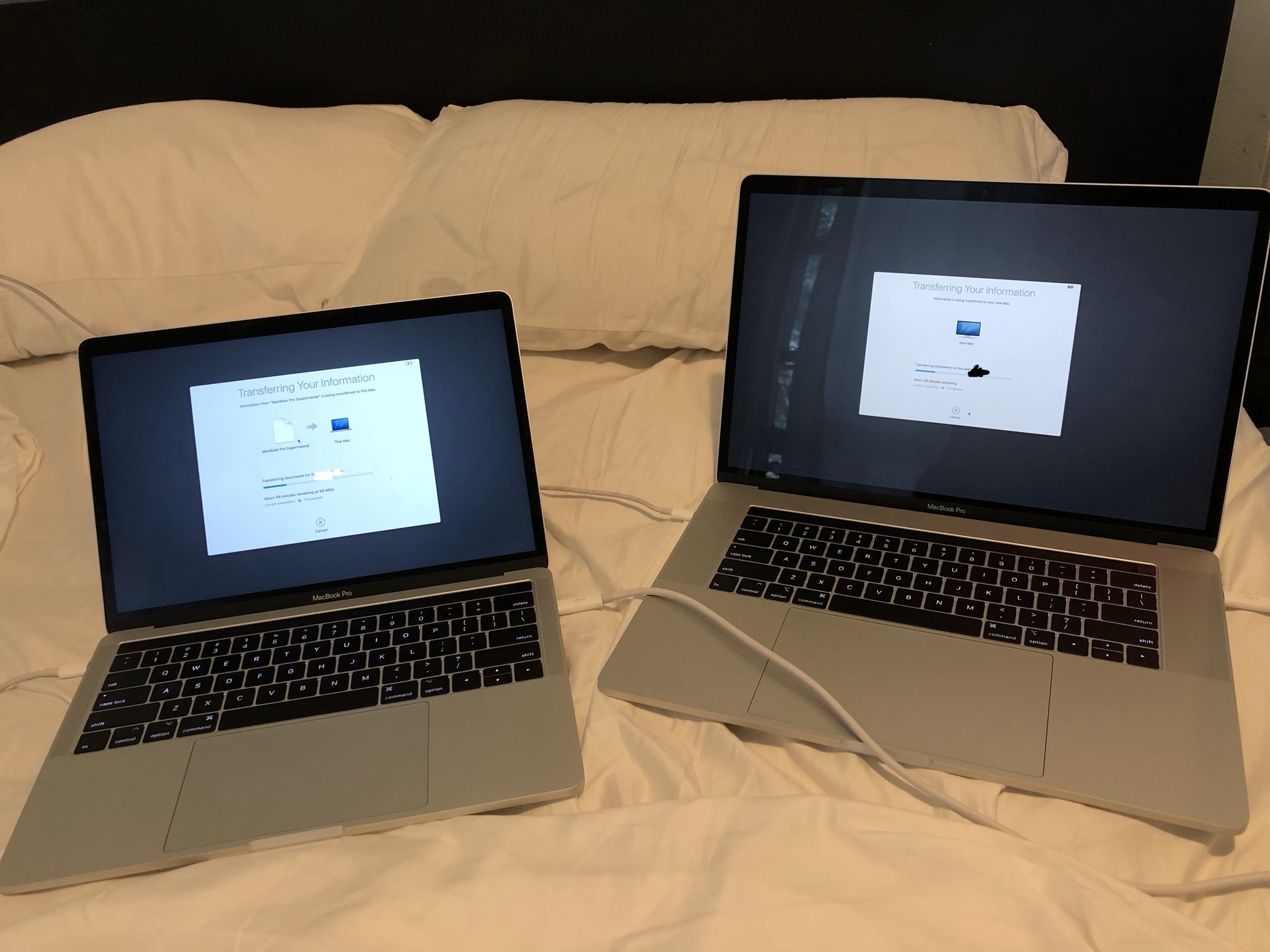

Also, I would be shocked if Migration Assistant had any say at the link speed negotiation level. It does correctly report Thunderbolt as the connection type. I didn't post this initially bc I didnt think it would come up but here is an image of the machines mid-transfer while at sub-standard speeds. You can clearly see the Thunderbolt logo under connection type.
@green86 Yes, while there is some variation in USB-C cables I am using the Apple Store sold Belkin USB-C to USB-C cable. This one: https://www.belkin.com/us/p/P-F2CU030/
It is certified to do it all. The cable was not the issue though I could try another one I suppose.
To your point about USB overhead I just don't see that man. That was true of iMac G3s but we are talking about top of the line Macs of the last 12 months. USB overhead? Not a factor here nor was there anything else running. Just so you know also, I have an external USB C SSD that does not skip a beat in huge file transfer speeds while using apps that encode and monopolize CPU cycles. 140 is dirt slow for what these connections ought to be able to do. Migration Assistant checks for conflicts at the beginning of the transfer. When its simply copying data it should travel at near link speeds. Its basically a transposed copy window. Again, I saw consistent 450mb/sec+ on slower interface hardware (TB2) with the same exact data less than 2 weeks prior.
Heres the image:
