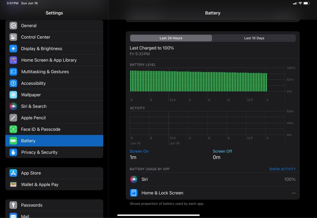

This is really annoying. Friday evening, I charged the battery to full. Didn’t use the iPad yesterday, a few minutes ago I turned it on less than 48 hours later and battery was at 72%. Looked at what’s been using the battery, it shows 100% Siri. I really hope they fix it, I’ve emailed support after opening a case on this with multiple screenshots, and they haven’t responded.

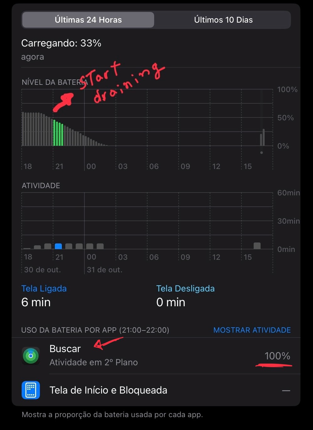

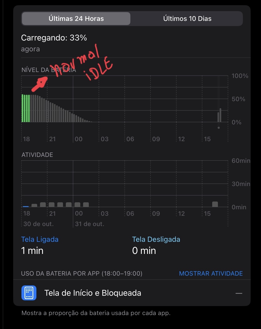

Same happening with me… I noticed a few weeks ago that my iPad air 5° was having the battery drain when suddenly I started to pick it up and it was turned off… I though it was Slack doing something on background and uninstalled. But today happened again and when I reach the battery stats it was shown that it was Find My… On my stats I can see clearly that it was idle just fine but suddently for no reason the battery start beeing drained.
Have to mention that this start happening on 17v… Now Im on 18.1 and still happening and there is no aparent reasons. It suddenly start draining until turn off…
