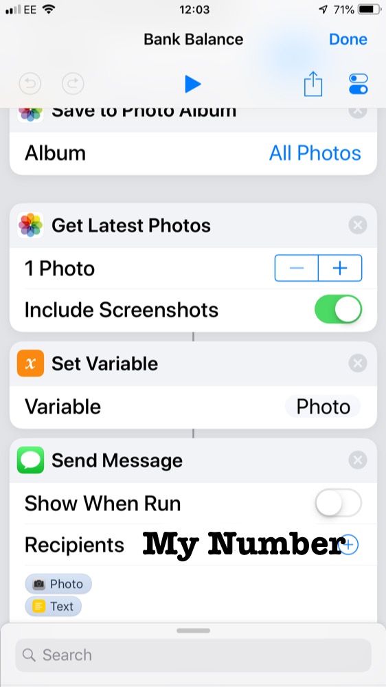

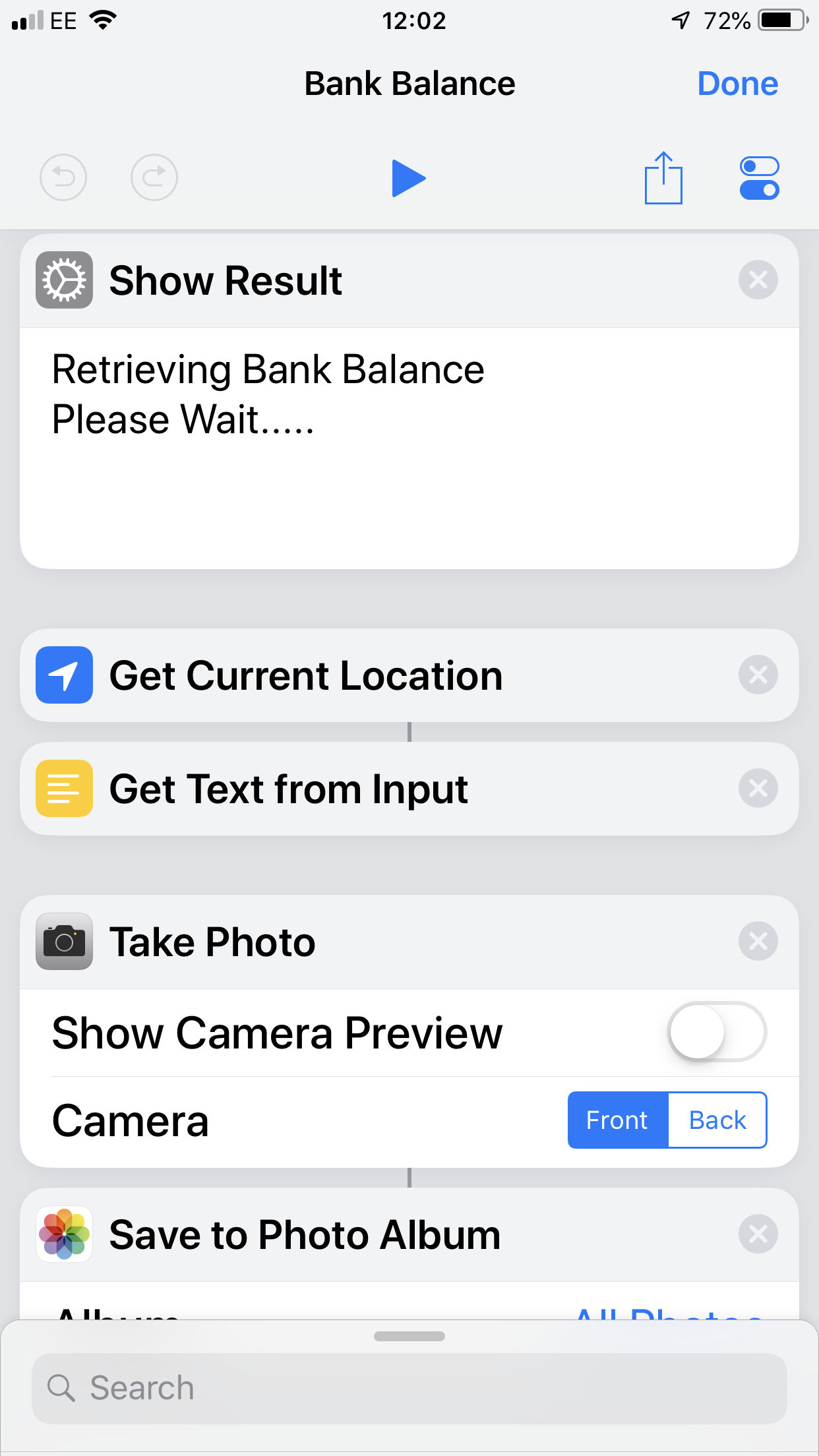

I am setting up a snooper trap shortcut to do the following
Create a shortcut with the title”Bank Balance”
When activated
Show alert to say “retrieving Balance Please Wait”
It then retrieves the location of the phone
And takes a photo with the front camera
(Hopefully of the Snooper)
And sends me a message with the photo and location attached.
Everything works fine, except it doesn’t send the message, it always opens it up in the messages app, and then I have to send manually.
I have show when run turned off
Not sure what I’m doing wrong
But I presumed it would send the message automatically

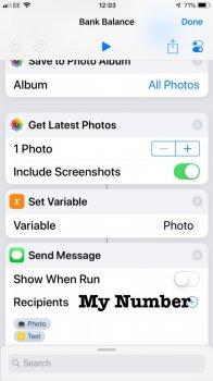

I have attached photo of my workflow

The first thing I looked for is the "Show when run" button on "Send Message". But your's is set to "No". Not sure what the issue is.
One streamlining note for you: you don't need to set the variable "Photo". Just use a Magic Variable in the text of the message (you'll see that you can select the output from the "Get Latest Photo" action).

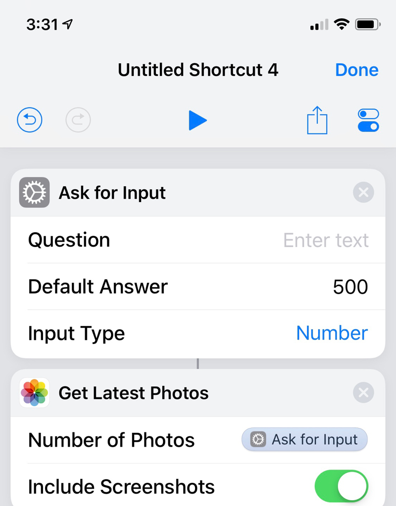

Also, you can grab many, many photos using the set up below. Or use a Repeat with Each action
