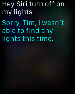

Anyone having problems controlling their hue lights with Siri on the Apple Watch?
Siri works great on my iPhone but when I try any commands that work on my iPhone I get this. Tried turning off Siri, rebooted my phone and watch, nothing.

What app are you using?
Yes, the watch is usually slower (than iPhone) for me, and sometimes gives the message you have or says it's having troubling communicating with the lights.
I can understand that but it hasn't worked a single time. And it's worked every time with my iPhone so this is kinda crummy. Thanks!
Try changing the Zigbee channel on the Hue bridge. Hue was rarely ever responding to Siri on the watch: changing the channel on the bridge means I get this message a *lot* less often now [In the Hue app for iPhone: Settings - My Bridge - Zigbee channel change].
That seems to have helped. I had to reboot both my phone and watch, and then it took a few tries, one time it even said Siri isn't connected to the iPhone. But after all that, it work 4 times in a row.
Clearly there some bugs with Siri to the iPhone which is sure annoying. Let's see if it keeps working.
Thanks for the suggestion!
I've tried using the watch sporadically through the day so far and changing the channel looks like it did it. Glad we have this on the net since there wasn't anywhere I could find that solution so others will know.
