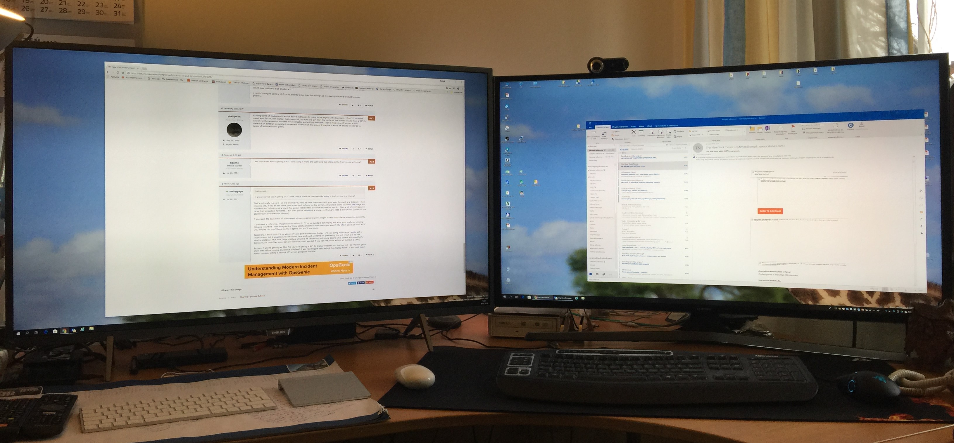

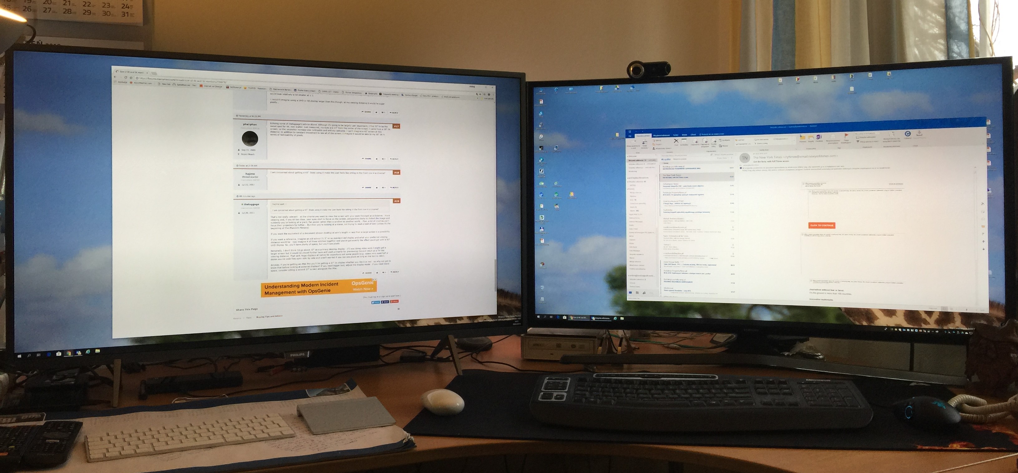

Echoing some of theluggage's advice above. Although it's going to be largely user-dependent, I find 32" to be the sweet spot for 4K, non-scaled. Just measured, my eyes are 23" from the center of the screen. I came from a 30" 2k screen, so the resolution increase was noticeable and entirely welcome. I can't imagine a 40" screen at this distance. In addition to constant movement to see all of the screen, I imagine it would be akin to my 30" 2k in terms of noticeability of pixels.

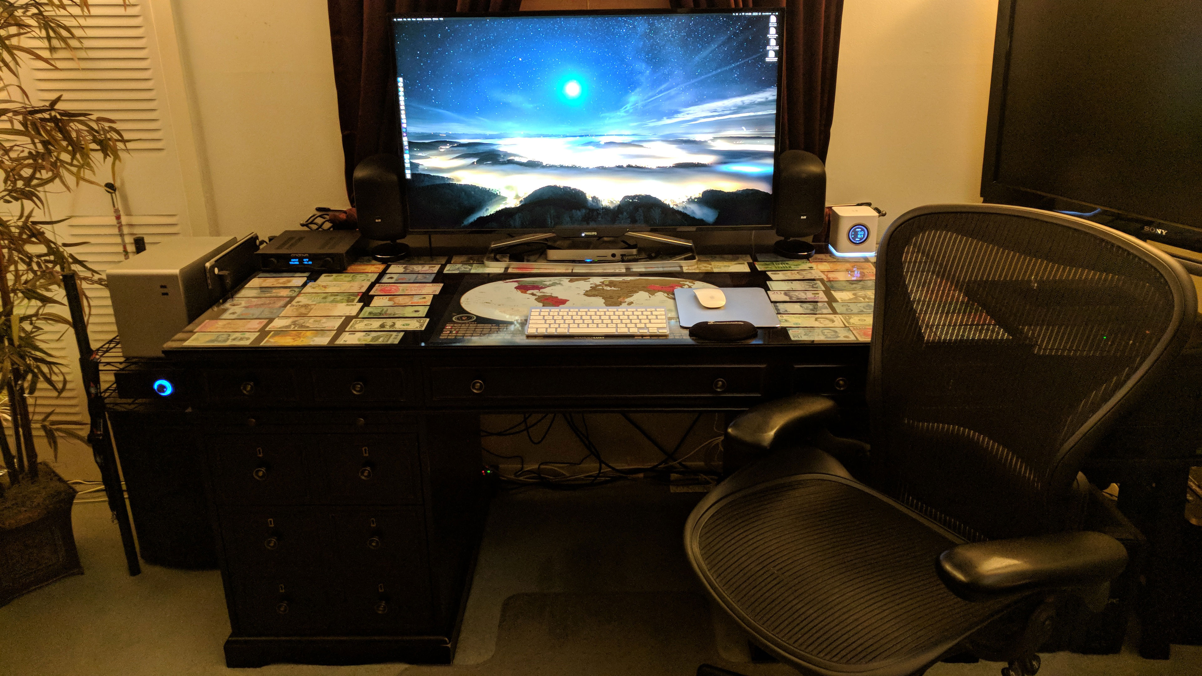

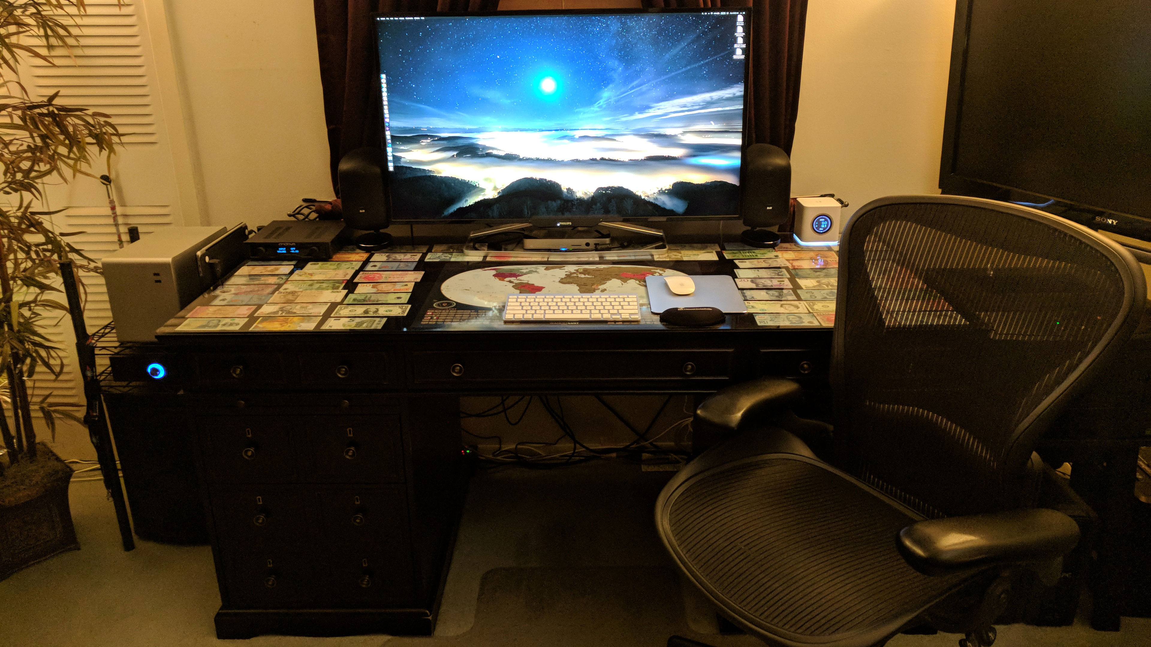

I am concerned about getting a 43”. Does using it make the user feels like sitting in the front row in a cinema?

That's not really relevant - at the cinema you want to view the screen with your eyes focussed at a distance - more relaxing and, if you sit too close, your eyes start to focus on the screen, perspective starts to distort the image and suddenly you're looking at a giant, flat poster rather than a window on another world... Plus, a lot of cinemas can't focus their projectors for toffee... But then you're looking at a scene, not trying to read a load of text (unless its the beginning of The Phantom Menace).
If you want the equivalent of a document-strewn desktop at arm's length or less then a large screen is a possibility.
If you want a reference, imagine an old-school 21.5" or so standard-def display and what your preferred viewing distance would be - now imagine 4 of those stitched together and you've got exactly the effect you'd get with a 43" UHD display. So, you'll have plenty of space, but you'll see pixels.
Personally, I don't think I'd go above 32" as a primary desktop display - if I was doing video work I might get a larger screen but it would be placed further back and used primarily for previewing the end result at a TV-like viewing distance. That said, huge displays at native 4k resolutions suit some people (e.g. coders who want half-a-dozen source code files open side-by-side and aren't worried if you can see pixels as long as the text is clear).
