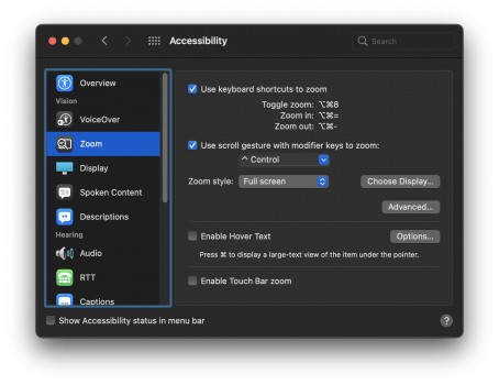

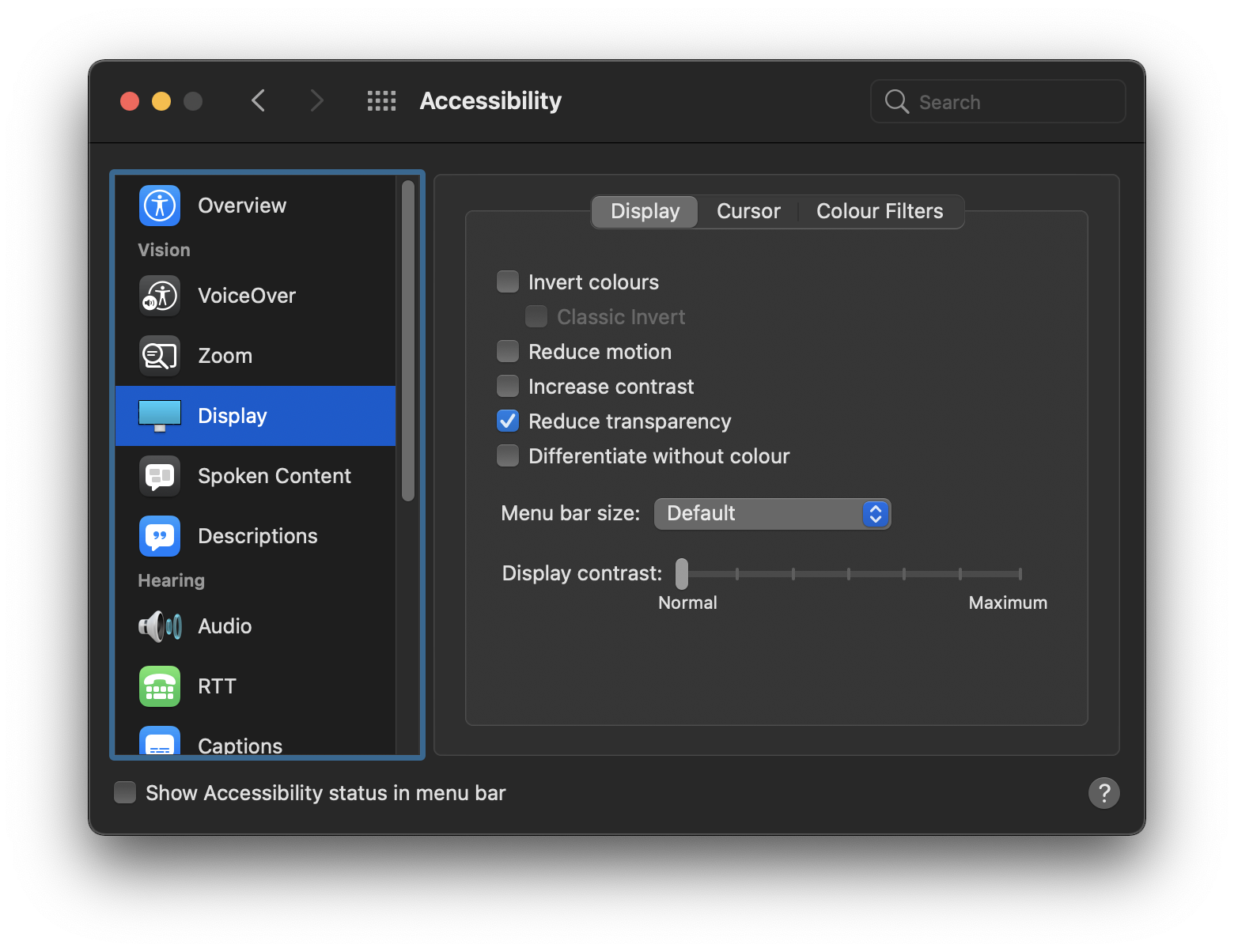

Perhaps you can find some useful options in System Preferences --> Accessibilty?

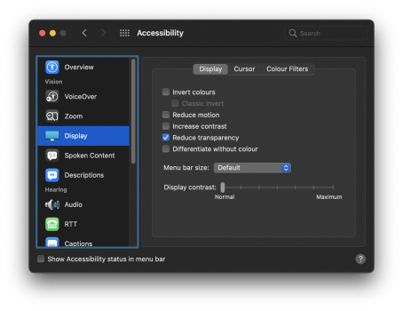

He mentioned increasing contrast, perhaps this would help?

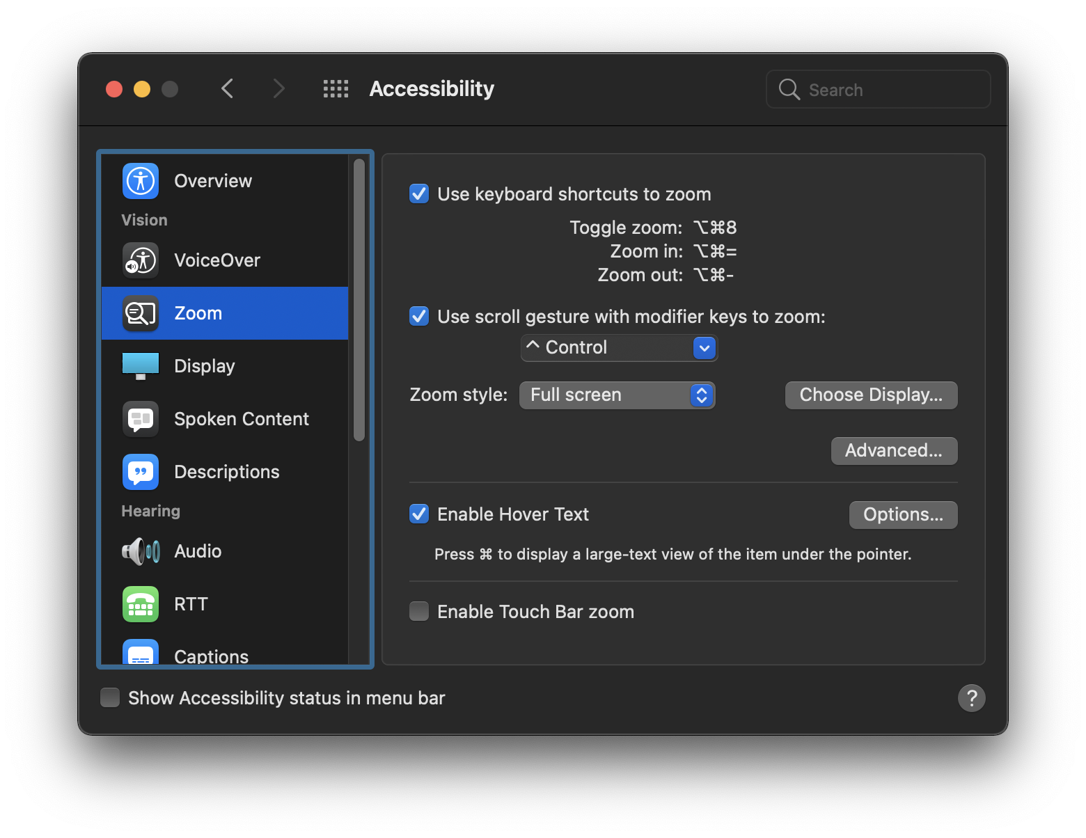

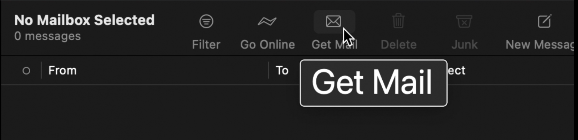

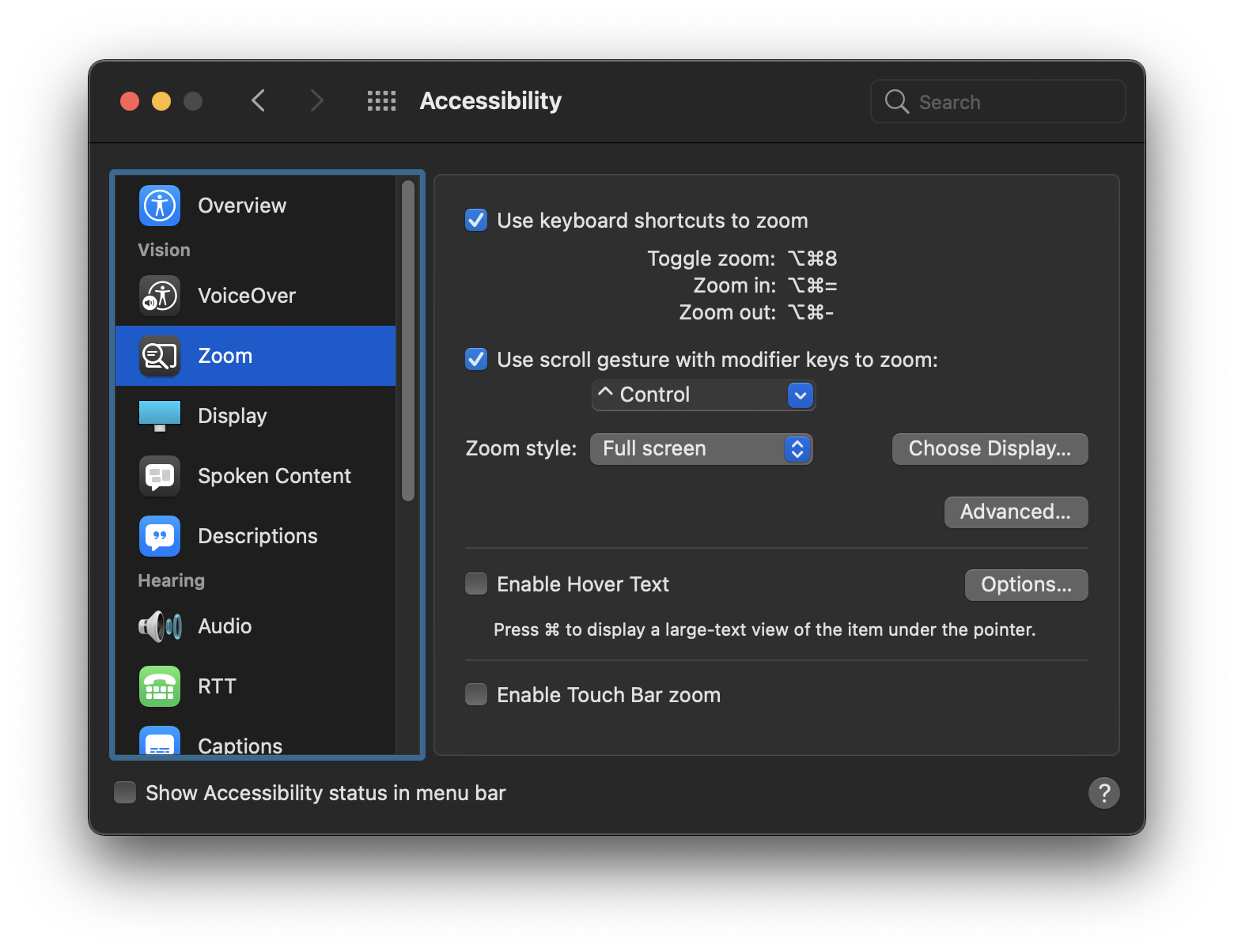

For your needs I'd advise trying System Preferences - Accessibility - Zoom - Enable Hover Text

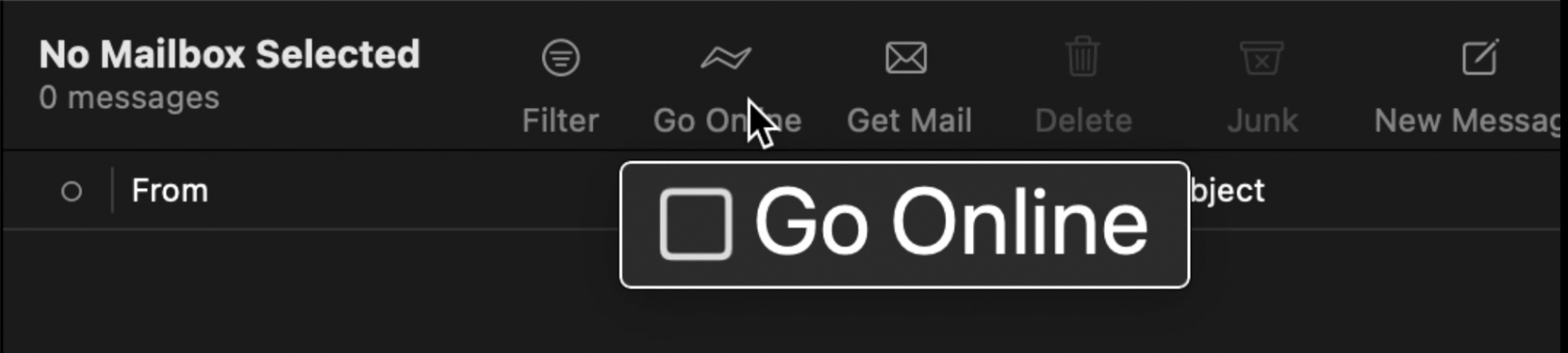

I just tried it and pressing the CMD key while holding the pointer over the menu item will indeed enlarge it in Mail.app.

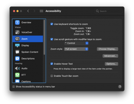

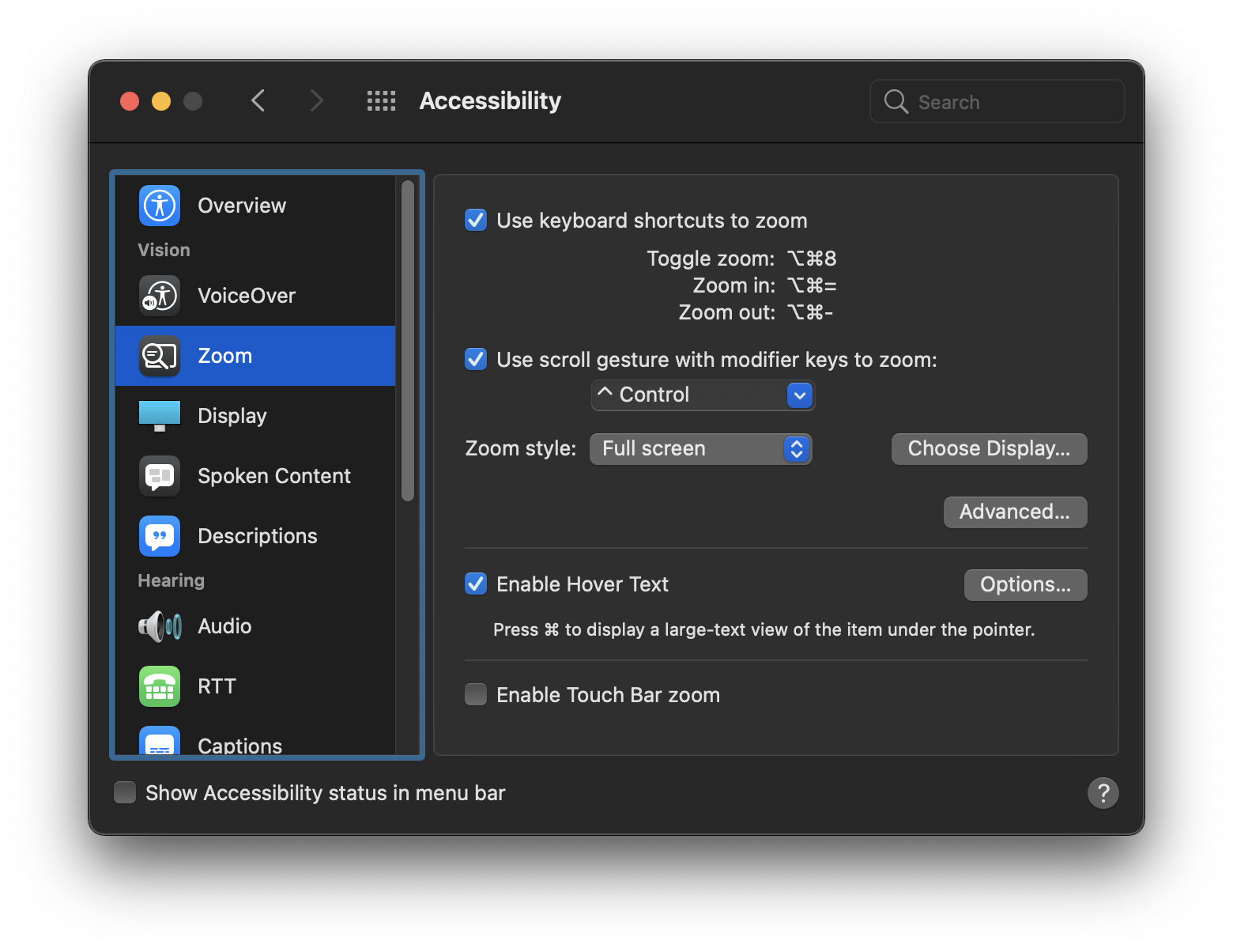

I do believe my suggesting is the best solution. It's a system wide setting that works in any application:
Enable Hover Text:

Thank you again, but my version of the operating-system (OSX 11.10.6) does not offer me Enable HoverText.

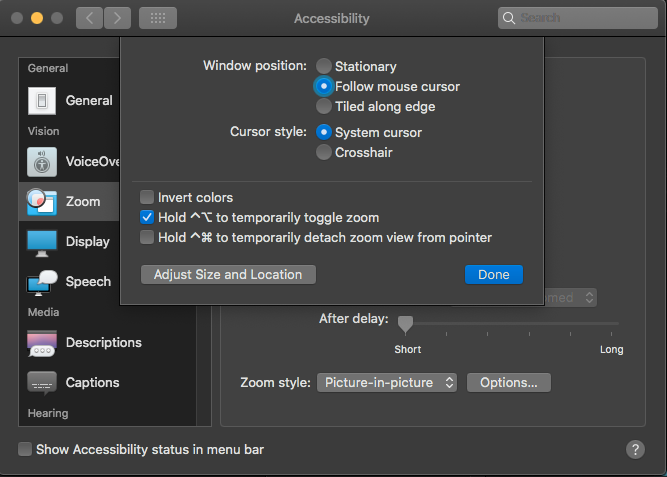

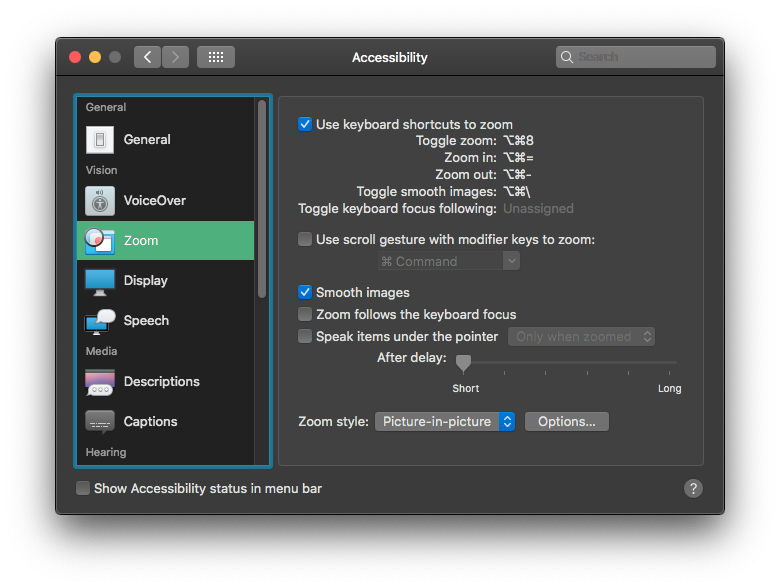

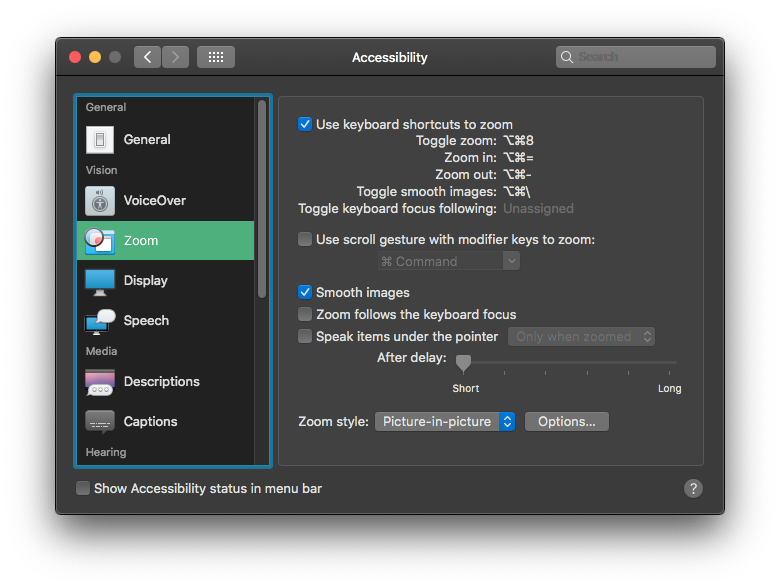

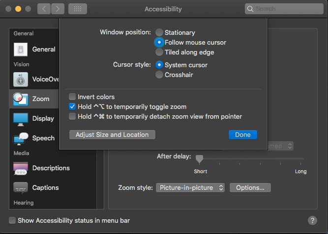

A setting that I use in Accessibility is the "Use keyboard shortcuts to zoom" and have the "Zoom style" set to "Picture-in-picture"…but "Full screen" might be your preference.
Clicking "Options…" I have these settings:
So now when I hold down the control and option keys together I get a picture in picture zoom window where my mouse is located. I adjusted the size of that window (dragging the corners) by, of course, clicking the "Adjust Size and Location" button.
I hope this helps.
I hope this helps.
Yes, that certainly does help --- thank you !

No, as stated beneath my signature, I use El Capitan. As the text there also discloses, this notebook is an antique or at least vintage MacBook Air, and El Capitan is the very latest version of the operating-system that it can accommodate. And by the way, I have now learned from this very helpful thread how to use Ctrl-Option with the mouse-pointer to achieve the result shown in your screen-capture. I am truly grateful to all of you that have come to my aid.
