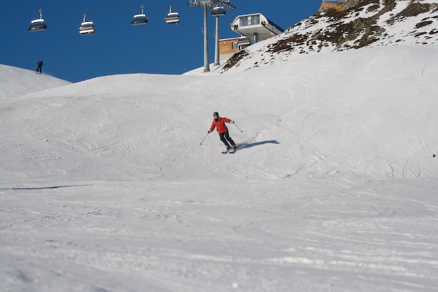

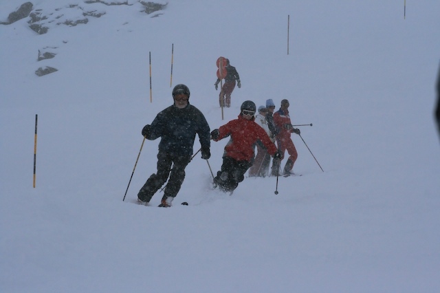

Whilst I don't have a 5D (I can dream) I thought I'd attach a couple of images from my Christmas ski trip in Austria. They represent basically the different extremes of the conditions. The first is from a brilliant sunny day without a cloud in the sky. The second is from a cloudy day with a lot of snow falling. The light was totally flat on the second day.
Both images were taken with a 400D/XTi and a 70-200 f4L.
The first was taken at:
ISO 200
f/4
1/4000
Straight out of the camera (taken in RAW)
The second was taken at:
ISO 800
f/14 (should probably have been wider aperture)
1/1600
This has been lifted a tad in Aperture then processed through Noise Ninja

I'm surprised you used ISO800 in the second example and not a wider aperture. My assumption was that I would have my ISO stuck on 100 or 200 most of the time with shutter speeds in the 2000-8000 range.
Thanks so much!! that is really helpful.
Basically an error but I wasn't really able to review what I was doing or sit in the snow too long. I'd already had to dig out a flattish area to kneel down in! But yes, basically a wider aperture would have probably resulted in a better exposed shot.
