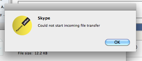

Wondering if anyone is familiar with this error. I keep getting it when people send me files through Skype. After some testing it appears that the file is accepted automatically and does in fact transfer to me- yet this message appears. The file transfer even goes through if I turn off "Automatically accept files" (!). See the picture attached for the message.

Sounds like there's some sort of conflict going on...
Wait for someone more knowledgeable to appear (I use Skype in a pretty limited sense), but I'd guess something buggy's going on at their end - since it doesn't sound like you're doing anything wrong. Busting through when you haven't deliberately accepted a file sounds a bit hairy.

I think since it's happening with EVERY transfer that it's probably on my end. So irritating.

This is definitely the issue. I'm just not sure WHERE Skype is putting the files. I've deleted the Skype folder in Library/Application Support (I kept my user information however- I'll look at this properly soon) and both plists, followed by installing a different version of 2.8, to no avail. I'm gonna have another look at the user folder soon, and see if there are Skype related files anywhere else.
So I've compared my version to someone who uses 2.7 and there are some differences.
Notably, when Showing Package Contents for Skype, and navigating to English.lproj (found in /Contents/Resources), all the .nib folders contain ONLY keyedobjects.nib files. The 2.7 files (without having upgraded to 5) also have classes.nib and info.nib in the .nib folders. I'm not sure what this could mean.
I'm now running 2.7 off a USB drive. I received a file and the transfer started automatically without the message! Gonna test a bit more and see how it goes.
UPDATED
I think I've got it. What I did was copy 2.7 to my HD and moved the user file found in 'user'/Library/Application Support/Skype/'username' out of it.
This forces Skype to rebuild one for you I guess. I then went to 2.8.0.866 and everything seems peachy! It should also reload all your chats. If it doesn't, copy all the .dbb files back into your user folder that you moved. If anyone has questions holler!
