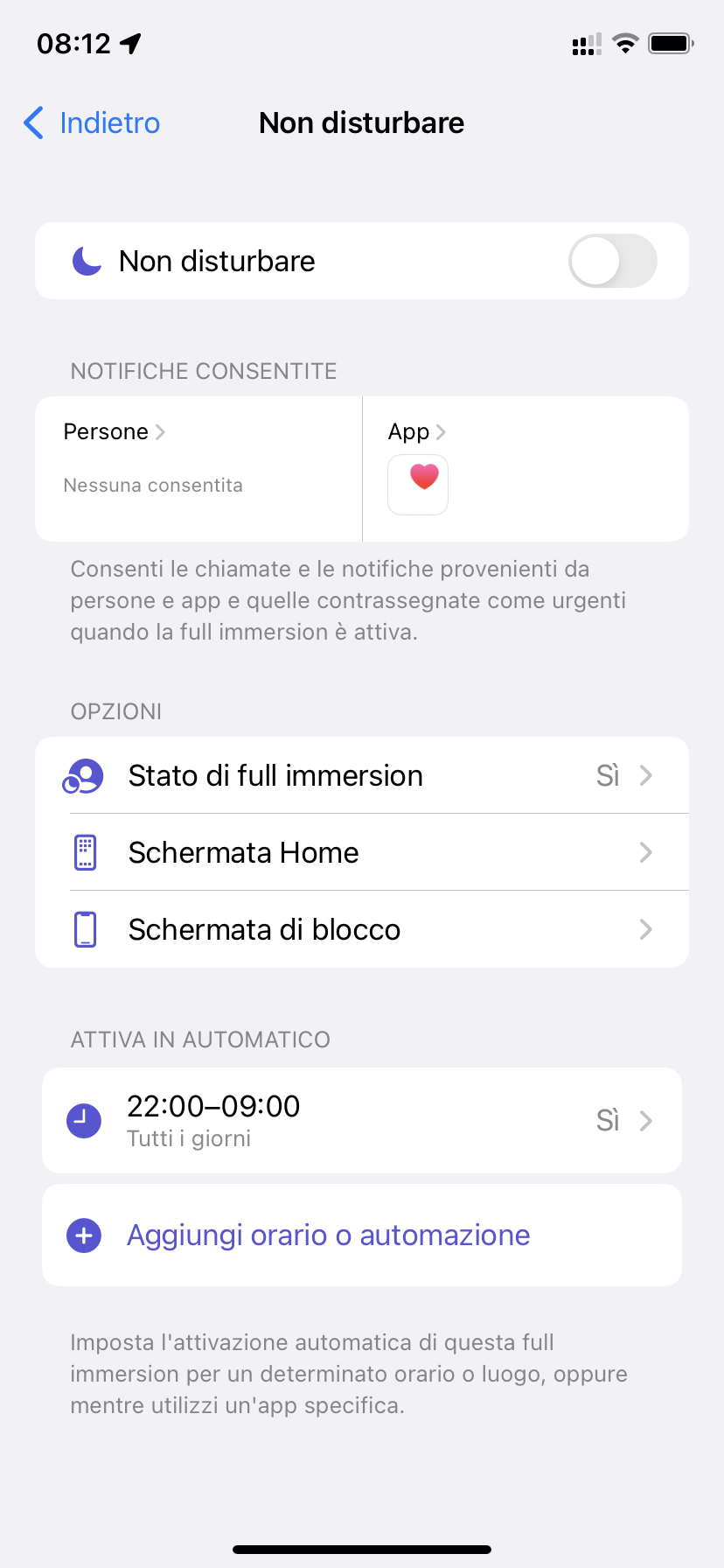

I think they completely broke "Do not disturb" in iOS 15.
Until iOS 14.8 I've always had Bedtime between 00:00 and 7:30 in the morning and DND between 22:00 and 9:00 in the morning. They always worked perfectly.
After upgrading to iOS 15 first of all I had to re-create my DND configuration: I set it between 22:00 and 9:00.

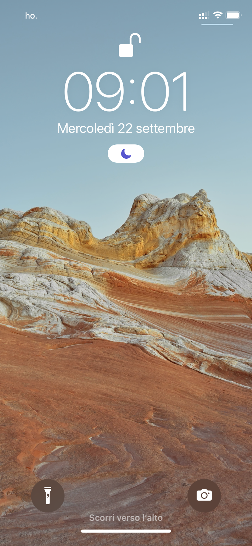

But... it didn't work at all! This morning, after waking up, I realised that around 8:00 in the morning, DND was already OFF.... why?! Well... I put it ON manually and I expect it to go OFF again at 9:00, but..... it doesn't work either!
Essentially I created a schedule for DND but it's being completely ignored.
See the screenshots:
In the left one you can see it's 8:12 and DND is already OFF. In the right one you can see it's 9:01 and it's still ON.

You can’t have 2 focuses active at the same time. Since both Sleep and DND are focuses, when sleep turns on DND will turn off. Use one or the other or set up 2 additional focuses that run from 22:00 to 0:00 and 7:30 to 9:00 respectively.

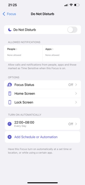

Do not disturb doesn’t work on my phone anymore.. I have it set to turn on automatically at 22:00 - 08:00 and it doesn’t do it.. am I doing something wrong?
