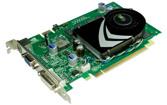

The typical GT120 (OEM model) has the ability to bridge the cards (see image). But as I've not seen the model offered in the MP, I can't be 100% sure the bridge connector is/isn't there.
Can you open your system and confirm if this is possible (PCB has the bridge connetion area on it on the top edge)?
Just checked and found this..
http://cgi.ebay.com/Nvidia-GT120-Vi...iewItem&pt=Apple_Desktops&hash=item1c142f0d32
It shows the underside of the card and sadly there is NO bridge connector at all 🙁

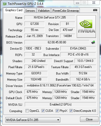

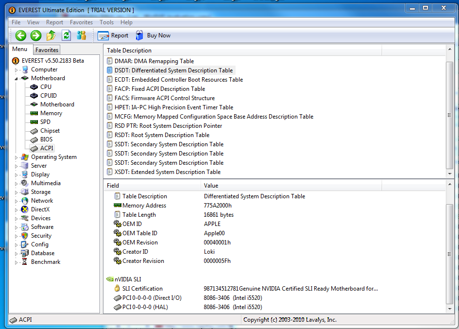

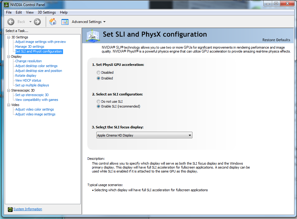

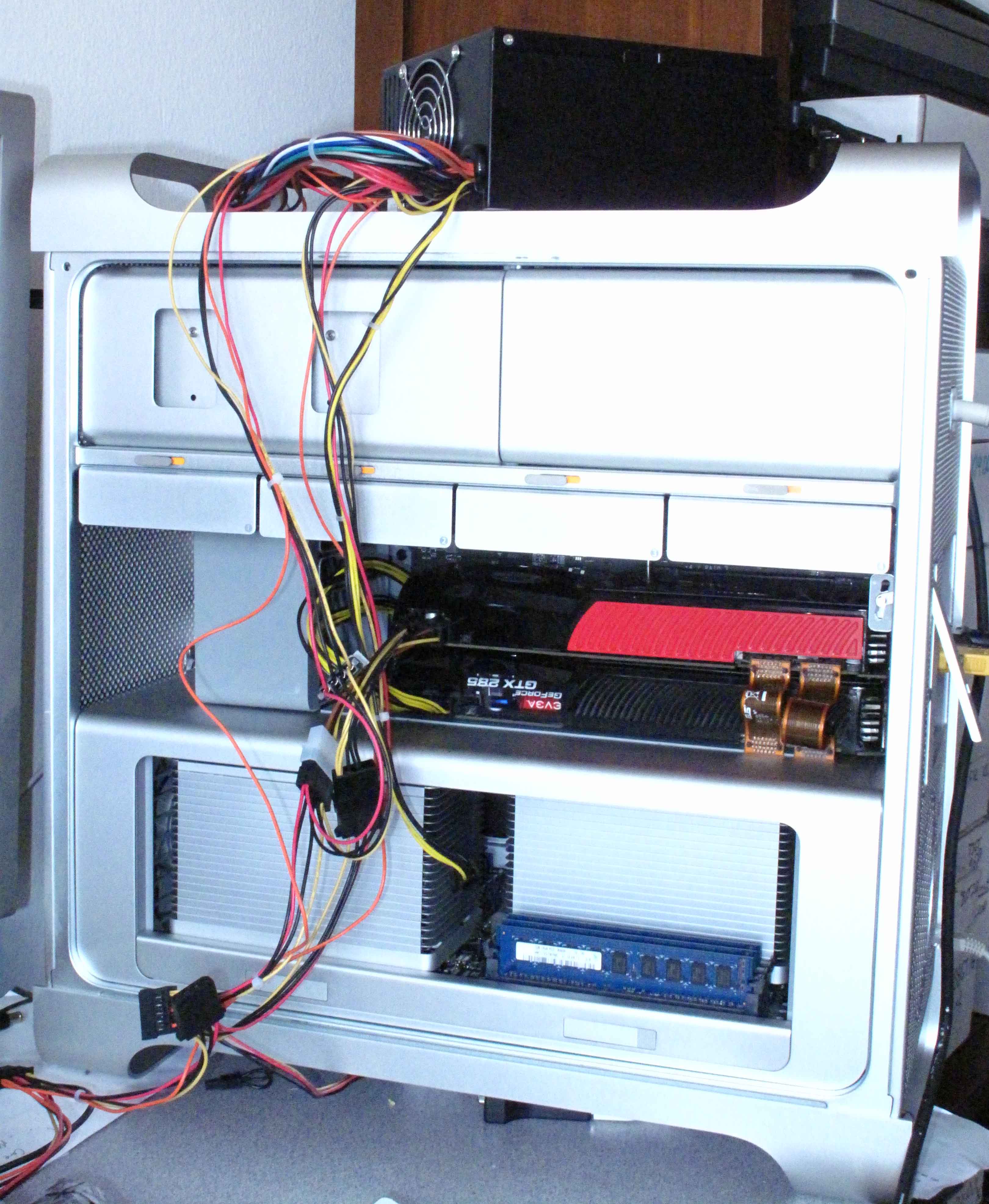

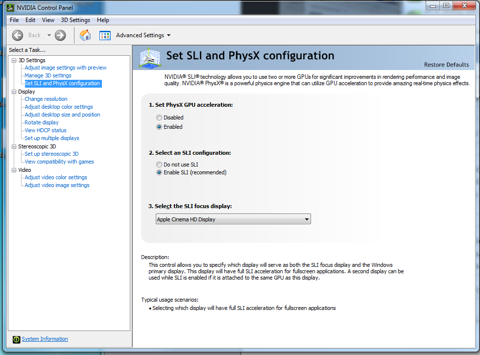

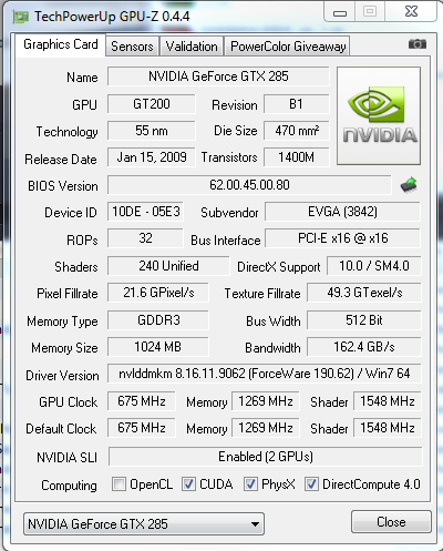

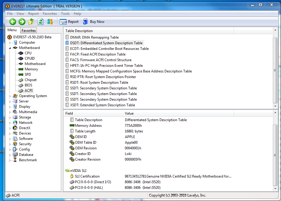

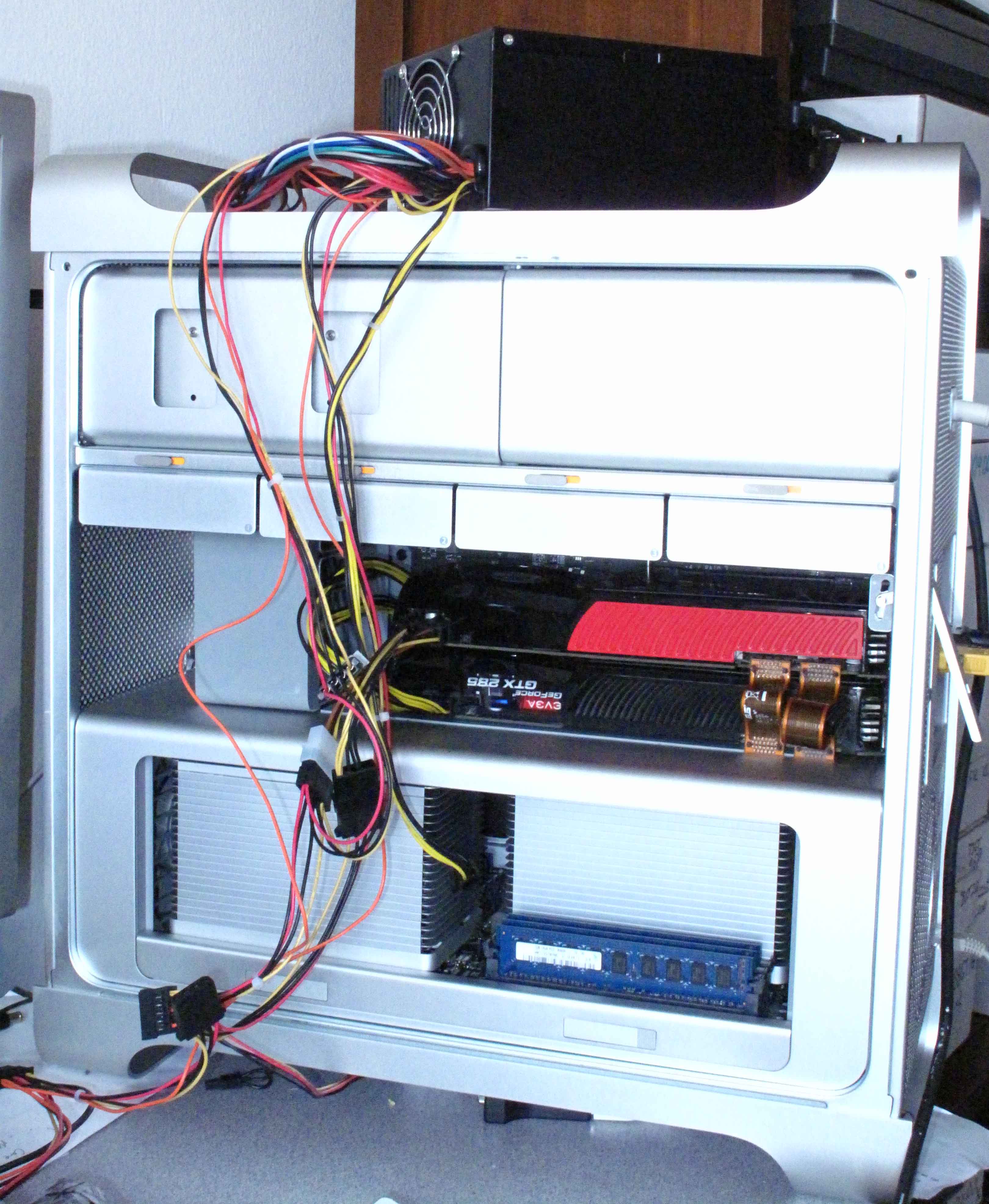

First Mac Pro SLI in WIn 7 DUAL GTX285s !!!
Thanks to Cindori for bringing this to attention.
I present .....
First Mac Pro to SLI a pair of GTX285s !!!
I started with a Fresh WIndows 7 Install so sadly I have NOTHING to test with yet so can't vouch for stability.
But using the backup method listed from Cindori's first post, I have enabled SLI !!!
I tried to use our beloved OpenGl Extensions viewer but it is a MUCH messier thing in WIndows. Can't find a "Benchmark" mode.
Also, whoever says "Windows 7 is big improvement over Vista and more like OSX" has been smoking the best Crack imaginable.
Still a clunky, stupid, obtuse OS. And still UGLY !!! Why does all the text look like ASCII from 1983? Why does it come loaded with DirectX 9 from 2004? Why can't I just FIND things with a quick keystroke like I've been doing on Macs since 1995?
Anyhow, here are some images, more info coming.
And to all the people who heckled Cindori for suggesting this might work....run on down to your local restaurant and order up a nice, steaming plate of Humble Pie. Absolutism rarely helps anyone.
So many more things we could do with Macs if more people TRIED things instead of postulating theories based on conjecture and opinion why it can't won't shouldn't ...yadda yadda, blah, blah. Armchair engineers don't invent or discover.
I will next try installing some games...sadly my legit copy of Crysis has been disabled because I have installed it too many times. I HAVE to use a crack on something I paid $60 for. After this I will try 8800GT, 8800GTS, and GT120.
BTW, SLI doesn't actually REQUIRE there be a bridge connector, so Apple cards might work.
Sorry it's kinda messy.
Had to drag a PSU out to power all of the PCIE connectors. Other cards won't require this.

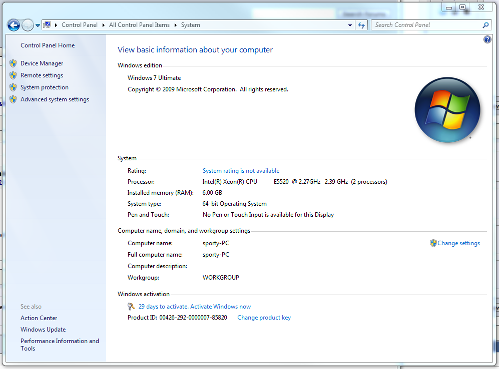

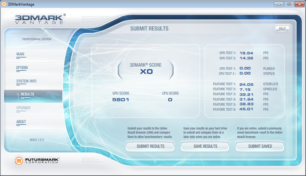

New Era in Bootcamp Gaming !!!
Wow !!!
When I was testing Crossfire on Dual XFX 1 Gig 4870s, I was underwhelmed.
Didn't add much power but did cost a bunch of money.
This is a different world !!!
Check the two sets of benchies.
3DMark Vantage & Crysis
Crysis was set to "Very High" on all settings and run on the 30" @ 2560x1600.
3D Mark was run on "Extreme" settings @ 1920x1200.
Both scaled nearly identically. The SLi setup was just under 2 times faster than single GTX285 !!!
The Crysis benchmark is the built in one. I have had trouble in past with the GUI ones. The top 3 runs were with SLi, bottom three with single GTX285.

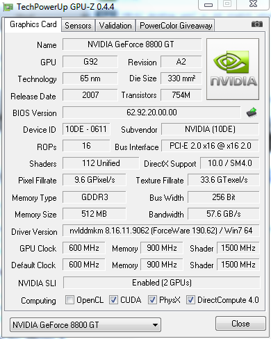

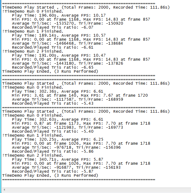

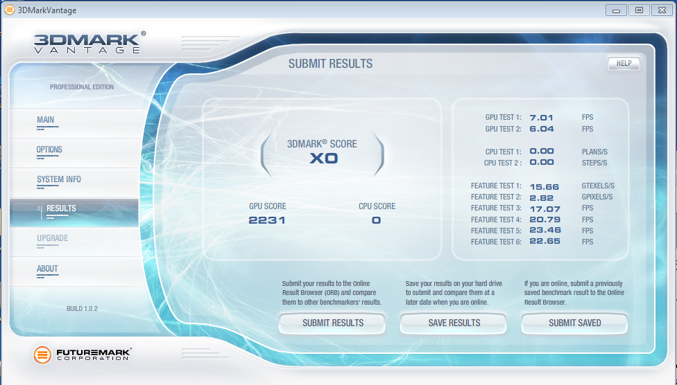

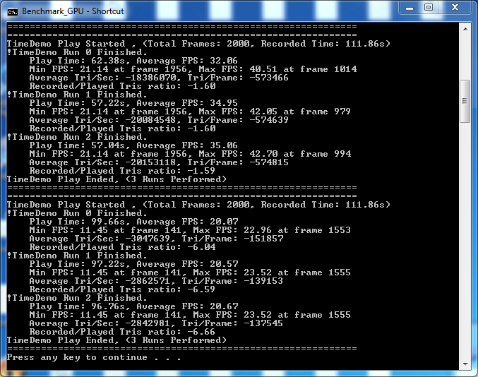

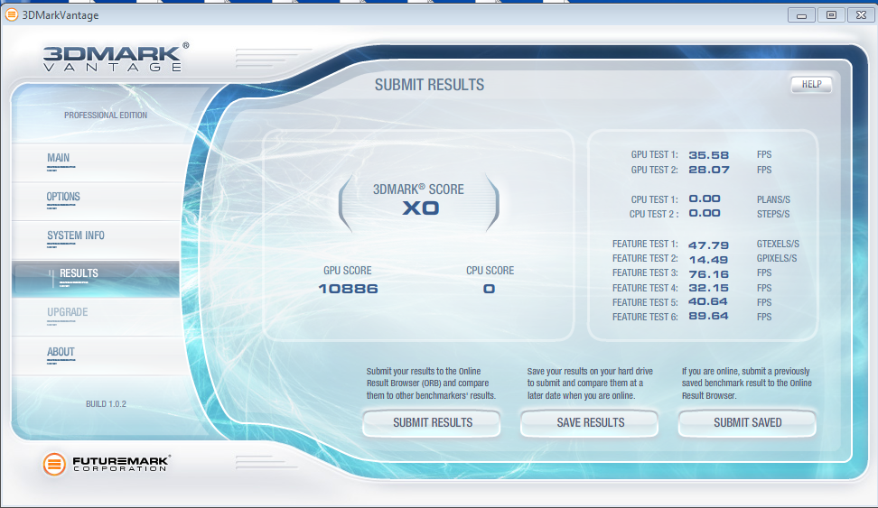

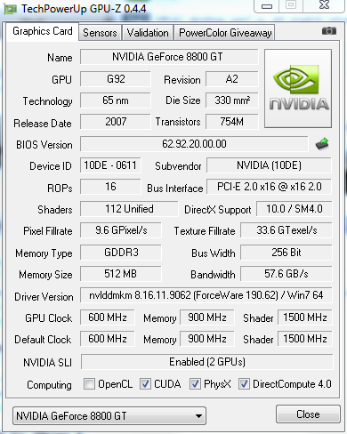

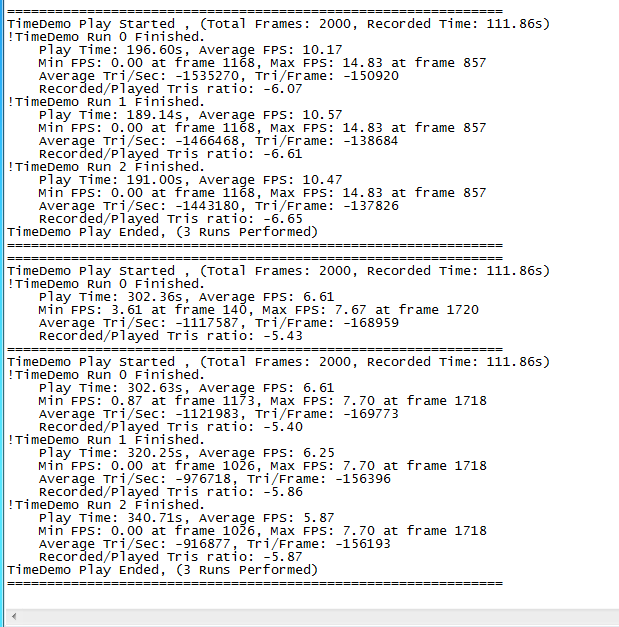

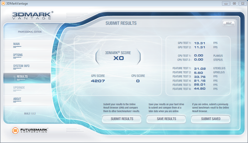

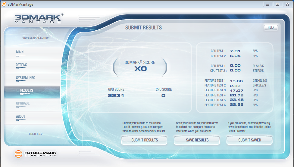

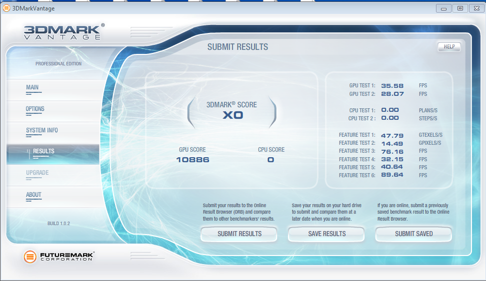

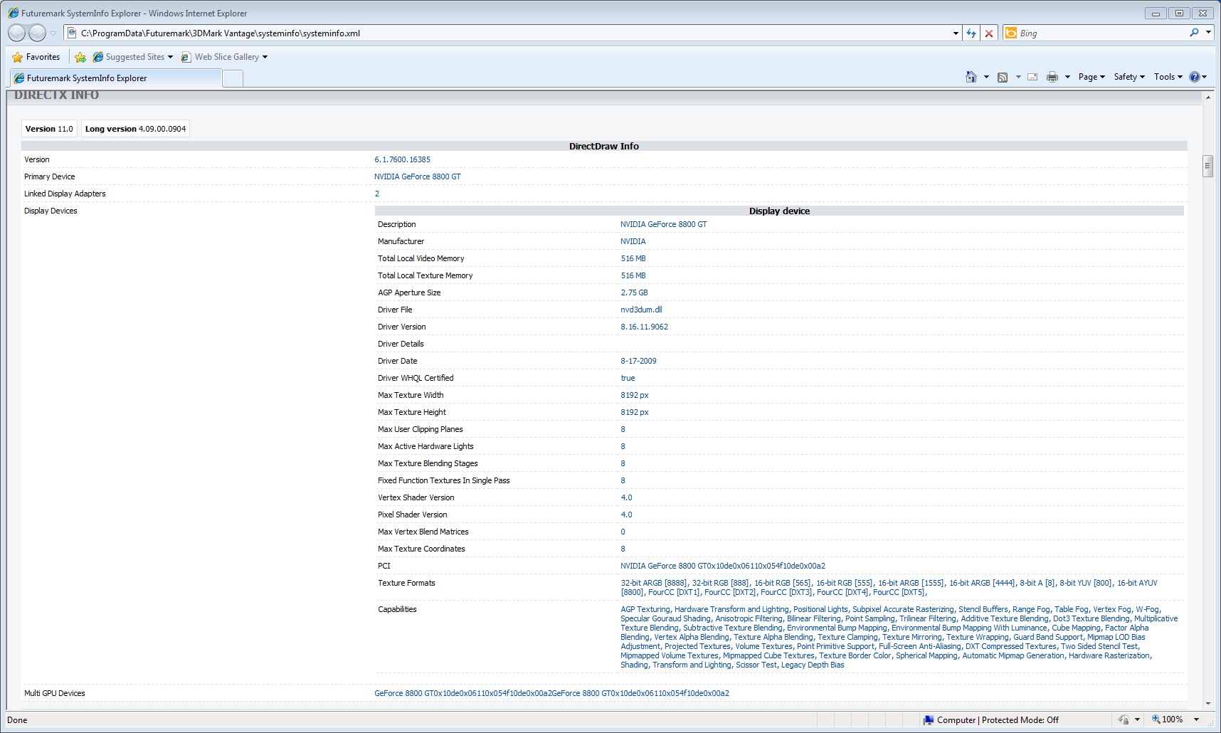

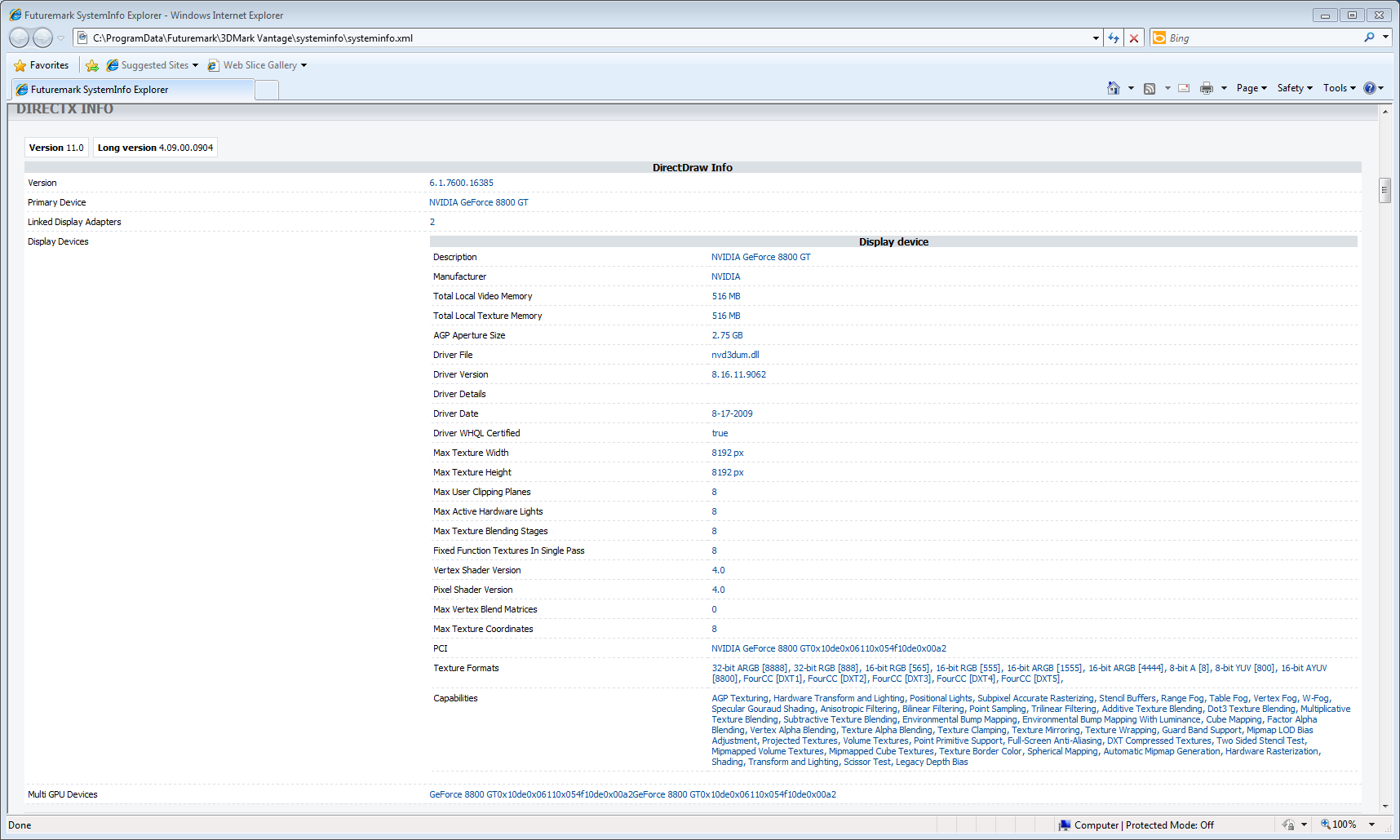

Mac EFI-64 8800GT ROM allows SLi
Yeppers, got 2 of them cooperating in Windows via SLi.
As with GTX285, it nearly doubles performance.
However 2 @ 8800GT still nowhere near GTX285 ballpark.
I left all the res/quality settings same as GTX285 SLi benchies...can you say "Painful"?
I had to reset benchmark config it to just do 1 or 2 runs each on Crysis. At 6 fps it was taking WAY TOO LONG. Take it down to 1920x1200 and medium settings and SLi with 8800GT could be viable, especially for 1st Gen folks who may be running out of other options.
In any case, obvious that adding an extra 8800GT to your Mac Pro can result in 40% faster scores in WIndows....if you go to some bother.
Some other notes:
1. Sadly, there is no Tri-SLi for 8800GT cards.
2. You need to go to some bother to set up, follow guide in Cindori's OP.
3. I tested with FLASHED versions of 8800GT with EFI-64 ROM. As Apple card has SLi connector, no reason to believe that OEM Apple 88GT won't work.
