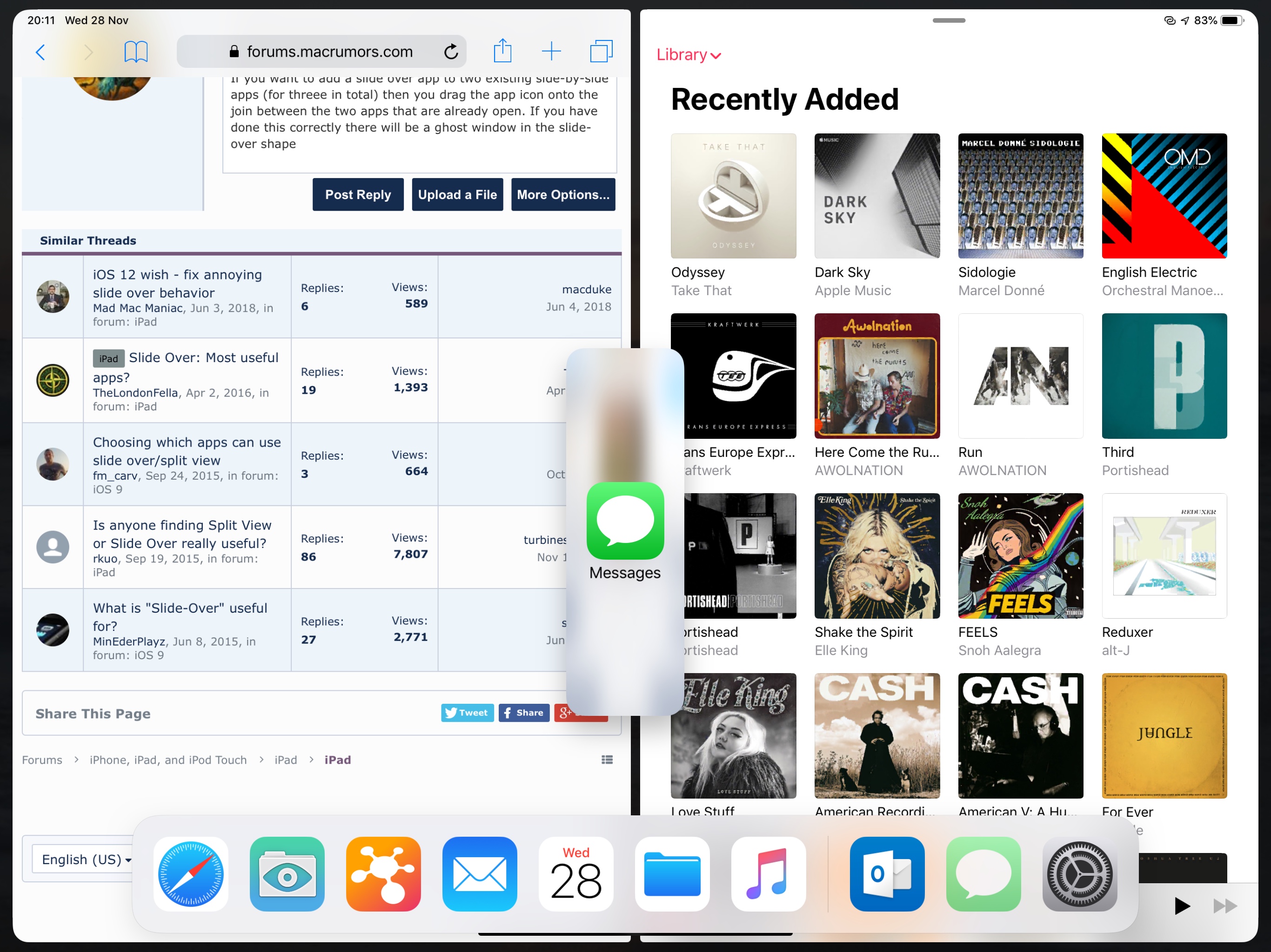

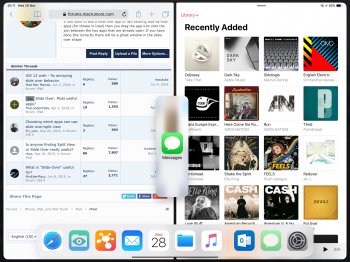

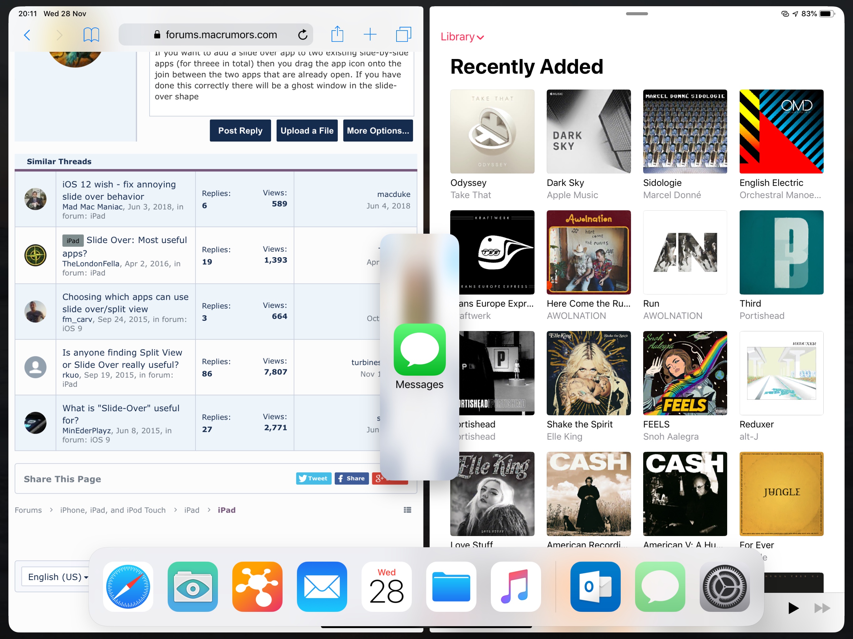

If you want to add a slide over app to two existing side-by-side apps (for threee in total) then you drag the app icon onto the join between the two apps that are already open. If you have done this correctly there will be a ghost window in the slide-over shape, like this:
If you drag to the left or right the ghost window will be square in shape, indicating that it would replace that half of the screen instead.

THANK YOU SO MUCH.
