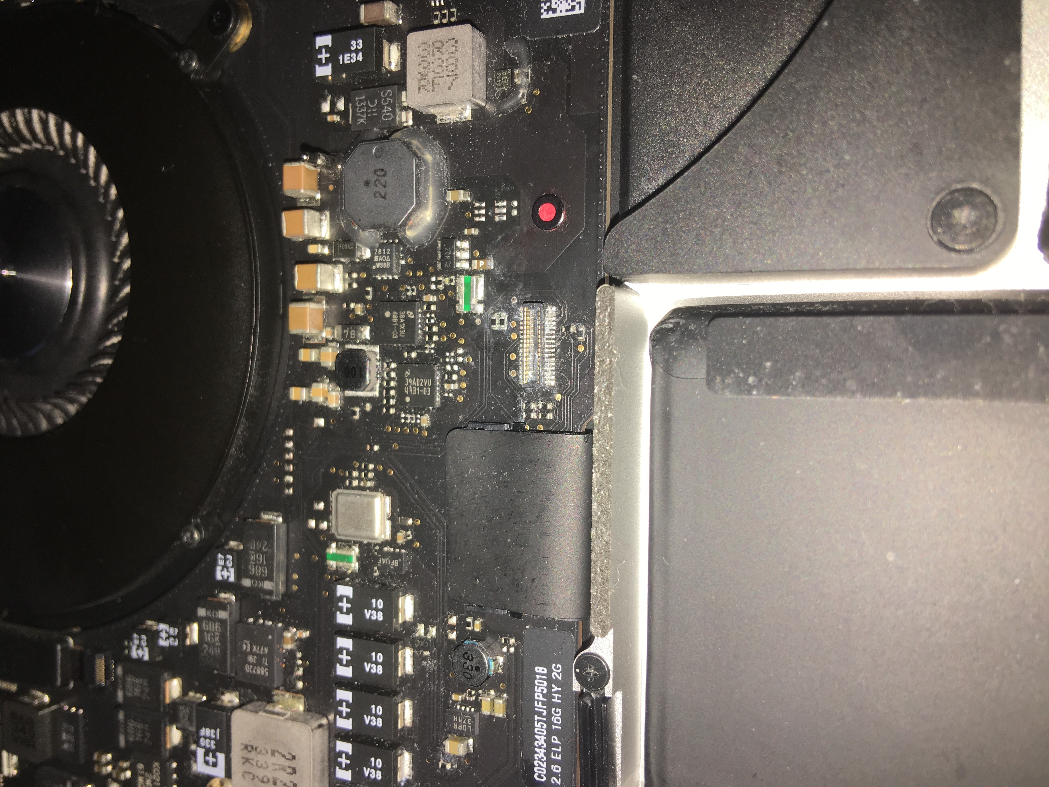

So last night during my sleep one of my pillows knocked over a small glass of water, and a little seems to have gotten into my MacBook.
I suspect the bottom left air vent slit has allowed entry as that area was the only area with an affected liquid indicator. From what I remember I gave it a good shake and moved it away from the damp area and fell back to sleep (I know I don't know what I was thinking..).
This morning it wouldn't power up, so I stuck it in a warm utility room for about 3-4 hours until I got back. Then I undid the backplate to inspect, there was a small sprinkle ontop of the middle chips along the logic board and an odd bit of residue above the batteries. I moped this up with some tissues and placed it over an aga oven in hopes of completely drying it out much quicker. I also gave it a good blast with a pressure air blower to get behind the logic board.
A while later and still no change, eventually I got the hair dryer out to warm up the stickers that had been budged a little during the air blowing part so that I could get them back into place.. After this, I gave it a shot with the mains lead and it started charging (lit up orange) but after an hour or two of charging the situation hasn't changed, nor is the brick warm..

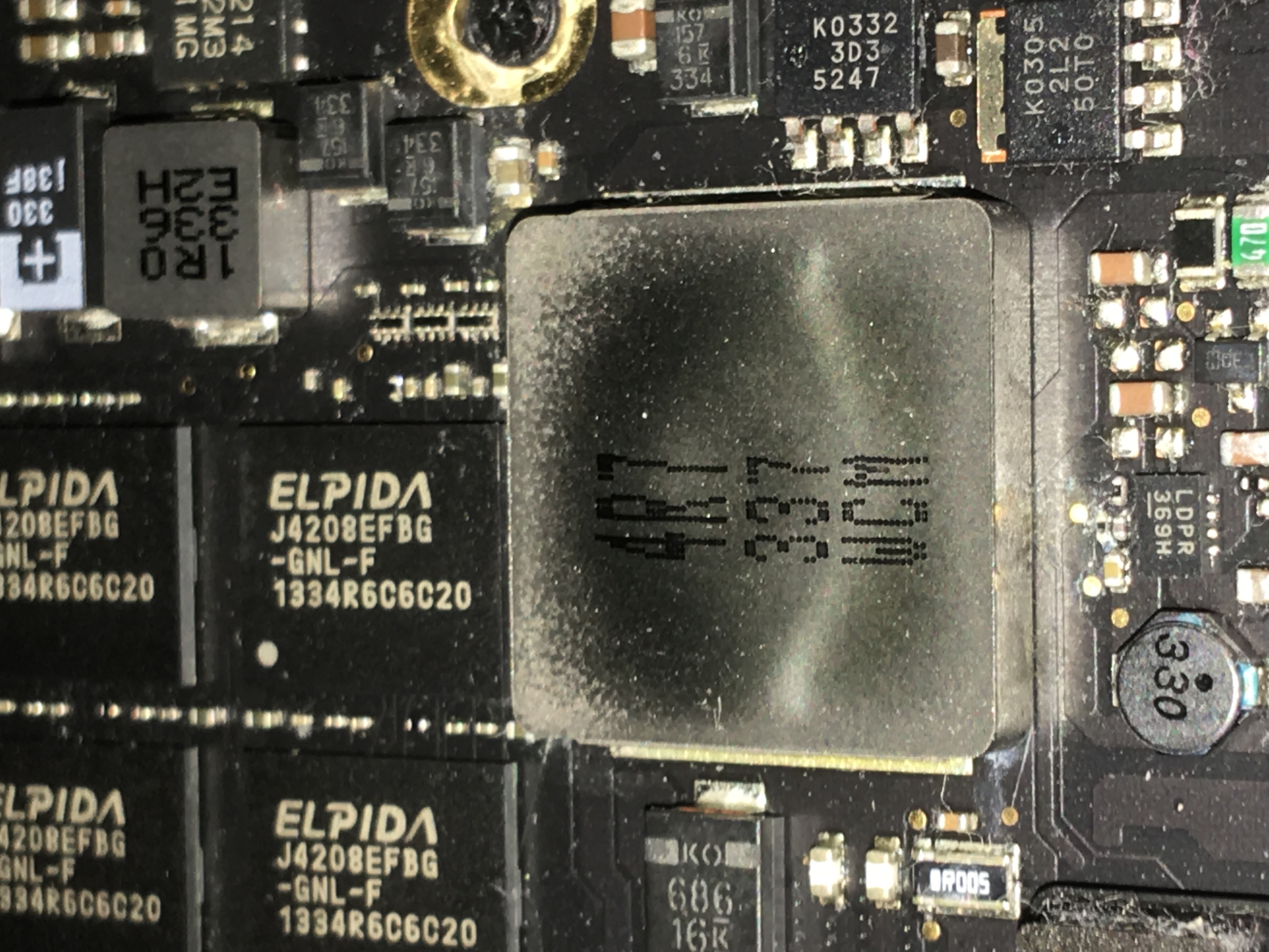

Is anybody able to tell me anything about this chip? It had the most blue/orange corrosion on:
wzs122id
It's to the right of that flap, and to the left of the red liquid indicator

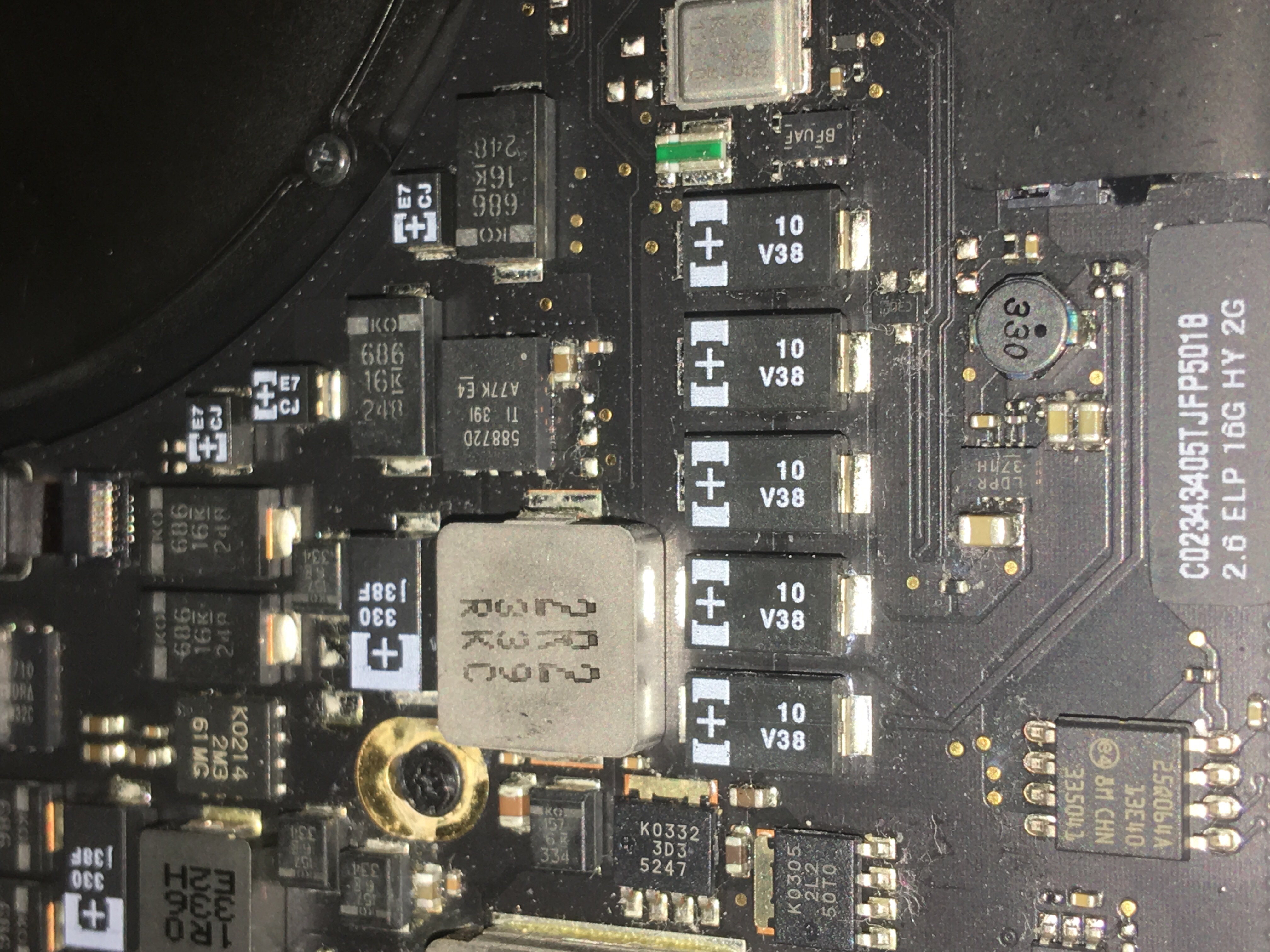

These strange looking battery chips also had a small amount:
4fvb5vqo
As did this:
g4th478a
The rest of the liquid indicators have stayed white, so surely it hasn't spread too far? I hope anyway..
