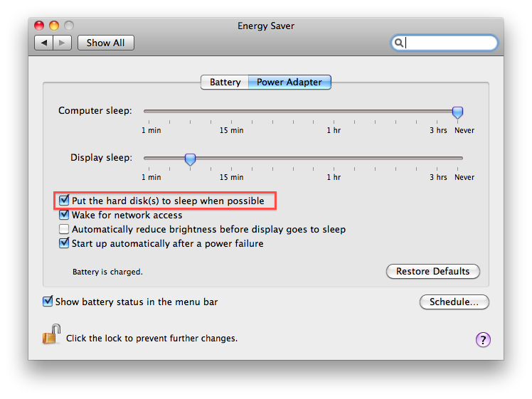

It could possibly be the fan, or just the hard drive spinning. Do you have this checked?
