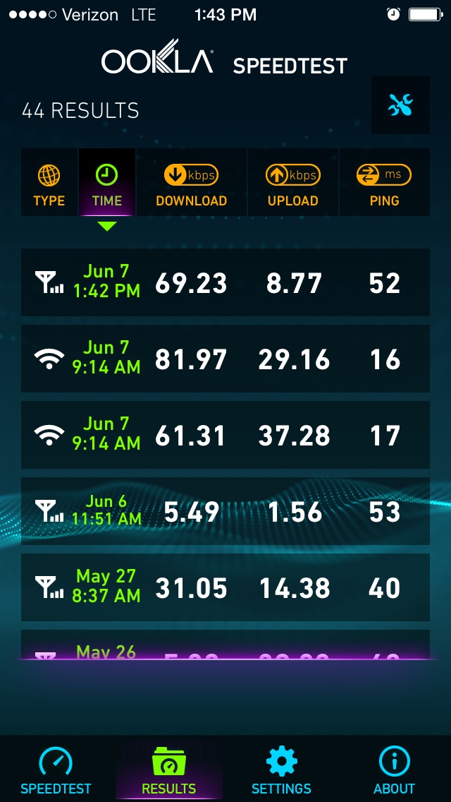

Here is my 5s on wifi, showing it's not the 5s.
