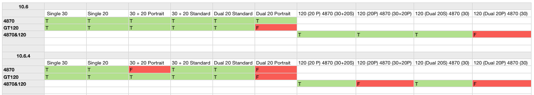

Probably want to keep a spreadsheet or some notes of the test configurations and results (and post them).
Excellent idea!
Done and ready for the analysis. 😀
So here we go, I know the results are more than odd, but that's what it is. 😱
I think I've got every possible configuration covered there.
What I read out of that table is that the problem is based on the portrait mode. Whereas in 10.6 only the GT120 has a problem with it, 10.6.4 doesn't like the portrait mode on both cards.
Going to non-portrait all the way is no option for me since I've paid a fortune for those 20 inchers.

I guess if you were willing to find out you could (update one at a time, clone, and test between each), but it would be a lot of work. So if you're unwilling, I completely understand. 😉 😛
😀 I am indeed. I'd rather buy a 5770 and test it with 10.6.5. If even that doesn't solve the problem, 10.6 seems to be my OS of choice (even though it has some issues such like volume control).
As per support, it's possible they've dropped the HD4870 and GT120 already. Especially given recent trends, such as dropping OS support for features that actually work, such as with the iPhone 3G.
But I truly hope not, as that's way too soon IMO (combined with the fact that they don't offer many choices to begin with, and are slow to release them; HD5870 certainly comes to mind....).
I sure don't hope that as well, but the times in which Apple supported "old" hardware have been over for years. Maybe they will realise that people can't drop $5000 on a new workstation every year, but then again I think that they won't stay in this market that long. 😉
I can test the 5770 in portrait this weekend, but I only have one screen.
That would be great, although with a single display, both the 120 and 4870 run well with a portrait display, the problem arises when two displays are connected.
Which connection does your display use? DVI?
Yeah, I know. It's all I can do though. Well, I suppose I could buy two MDP to HDMI adapters, then hook up my girlfriend's monitor, and drag my big screen TV into the office for a third display... but I don't like you that much. 🙂
DVI to a 24" Dell Ultrasharp 1920x1200x60
I'm looking forward to your result in portrait mode, although I'm almost certain that there won't be a problem with both 10.6.4 and .5.
