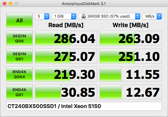

Here is a single SSD from my Mac Pro 1,1:
That is about halfway full, and around the speeds you are getting.
