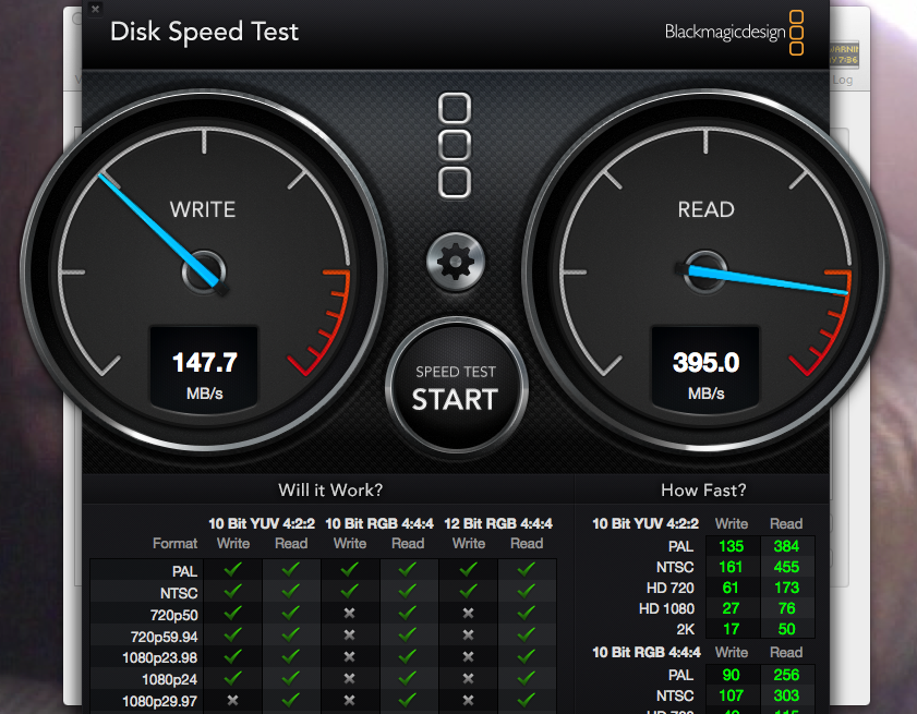

I have a 2012 Macbook Air 11" 64GB, its only getting 150/MBs for write speed, and 390/MB/s for read speeds.
My main concern is the slow 150/MBs for write speeds, thats the highest it will go.
My older 13" 2011 Macbook air with 128GB ssd always gets 250/MBs for Read and write speeds.
Anyone know what the issue is?

Try disk repair in the recovery drive.
I always find a rebuild from scratch can help.
Are you using FireVault, it has a small impact on performance. It sounds to me like there is something else going on with your system. Try booting into Recovery Mode and repairing the disk & disk permissions.
The speeds are normal for the controller on the 128GB ssd. It probably is one from Toshiba which uses the Sandforce controller. Sandforce controllers will only reach the mentioned speeds when the data is easily compressed. When it is not the performance will be horrible. The tool you are using to test the disk speed is using data that is not easily compressed and thus it shows horrible speeds. However, like I said, these speeds are normal for that controller so nothing is wrong. If you want to upgrade then get a Samsung one. Do not use any from OWC since they use Sandforce controllers only and thus you'll have the exact same "problem".

What I'm trying to do is make you understand what you are saying and how ssd's in general work instead of repeating whatever marketeers tell you. The ssd's with a Sandforce controller work differently and it is this difference that explains the things the OP is seeing. What he is seeing is not a problem, it's a property of the Sandforce controller.
Your points are very weak because there is simply much more to it. For example, compression and encryption mean that either the cpu or the microcontroller on the ssd needs to do some calculations. This takes time and can affect speed (in either a positive or a negative way). When we look at the various reviews for different ssd's we can clearly see that the Sandforce controller has no big advantage over the competition. They are in the same range except for uncompressable data. It is what it is. It's just another controller, not something magical as you seem to believe. Nowadays almost any ssd will be good enough but there are quite a few that will be better.
