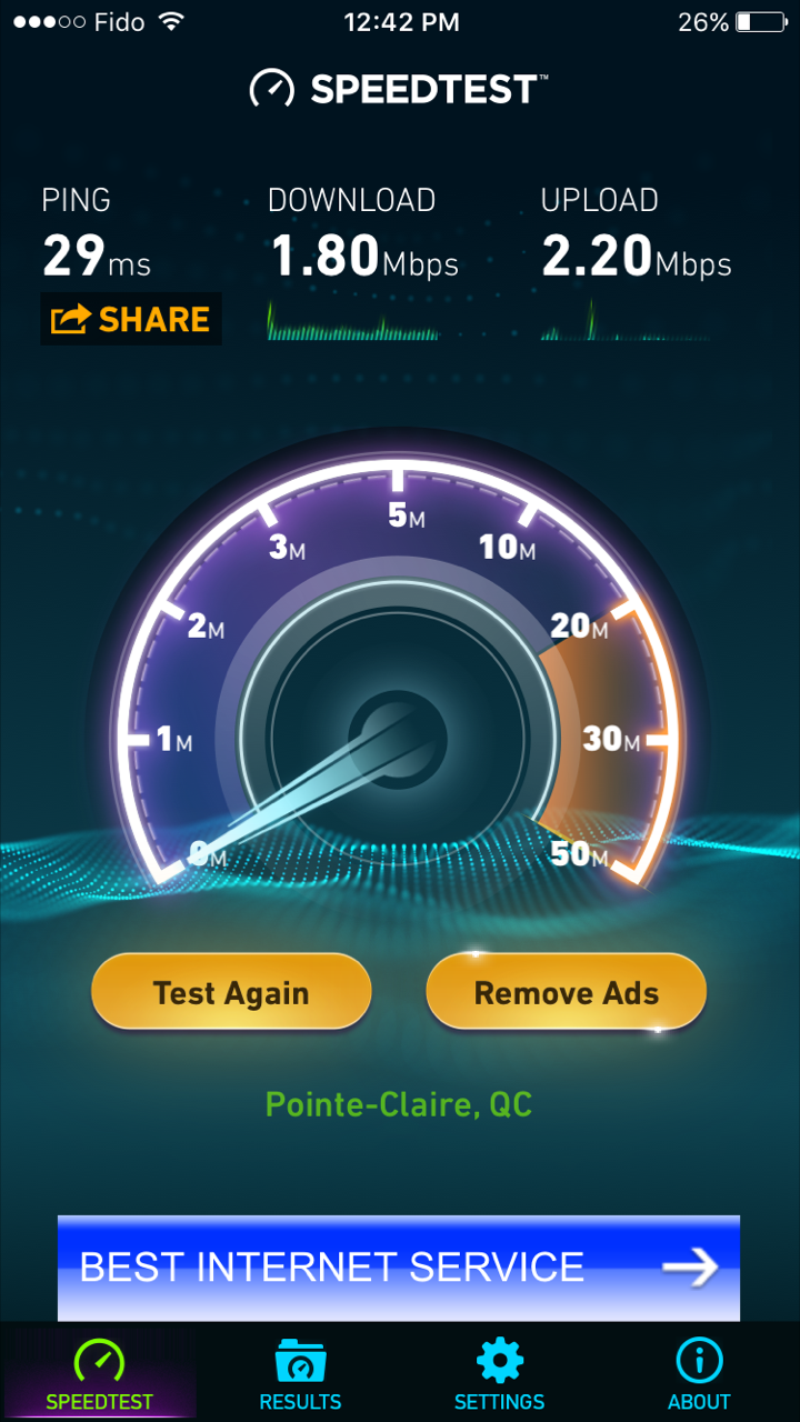

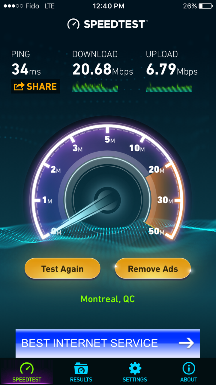

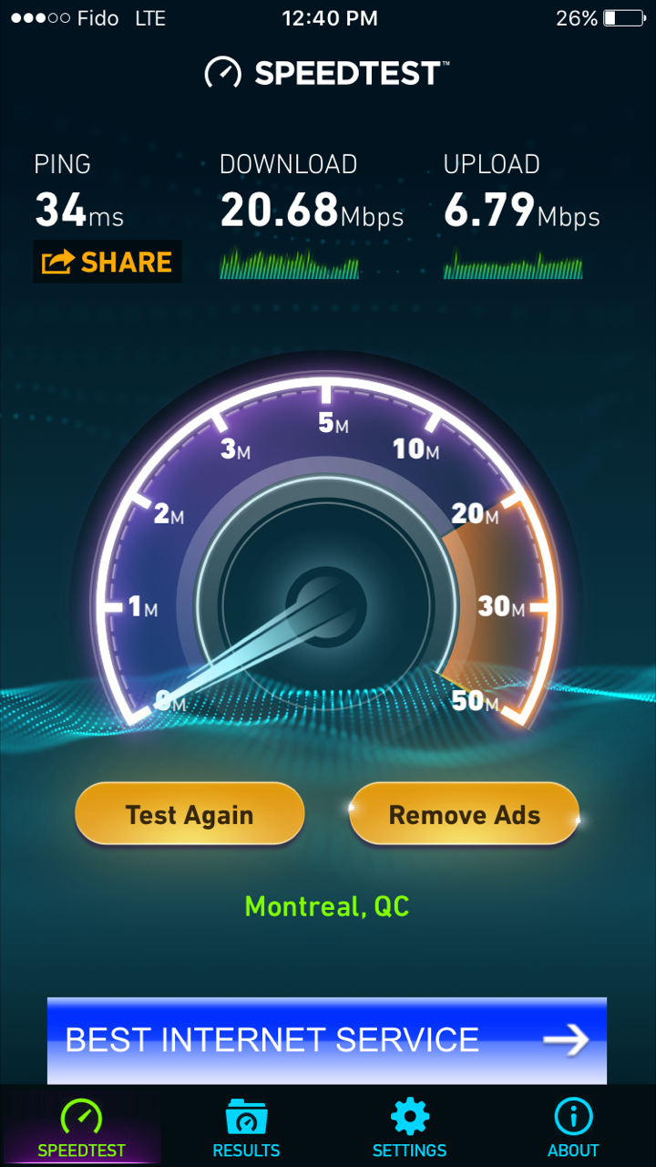

So I have "unlimited" home internet with Rogers (Canada) and they claim 100mbps down and 10mbps up. The pics below are speed test results comparing my home wifi with my LTE Fido using my iPhone 6S. The LTE is noticeably faster with my iPhone 6S. I have a 2014 rMBP which gets very similar results for wifi on the 5Ghz band. Doing the speed test on the 2.4Ghz band is painfully slow. My Rogers modem/router is connected to an Apple Airport Extreme (Model # A1408). Anyway of speeding things up? I'm not talking about downloading big files. Just loading the average webpage. But even doing App updates is really slow and make web surfing virtually not possible while the updates are happening.
WIFI

LTE

How do you have the Extreme set up? It should be set to Bridge mode if your Rogers box is a router.
Is the Rogers box also wifi? If so, what happens when you connect to the Rogers wifi, rather than through the AE.
What speed do you get if you connect directly to the Rogers box using ethernet?
thats not normal at all!!!!....something is wrong with your setup........interested to see what your answers are to JohnDS questions
I agree with JohnDS above.
If the Rogers box is a "residential gateway" (combined modem and router in one "box"), let the Rogers do NAT.
Go into Airport Utility and set up the Airport Extreme to be "in bridge mode" (i.e., it does NOT do NAT).
Also, TURN OFF the wifi on the Rogers box if it's on.

Okay so I did some overall test and the highest I got was 143mbps down and 11mbps up. I got close to that for DL on both wifi and ethernet with the Rogers box and the AE. That was both in the living room and the bedroom. My apartment is very linear and my bedroom and living room are at opposing ends. It was only when I tried the AE wifi from my bedroom that I got as low as 2.53ghz DL and 5.78 UL.

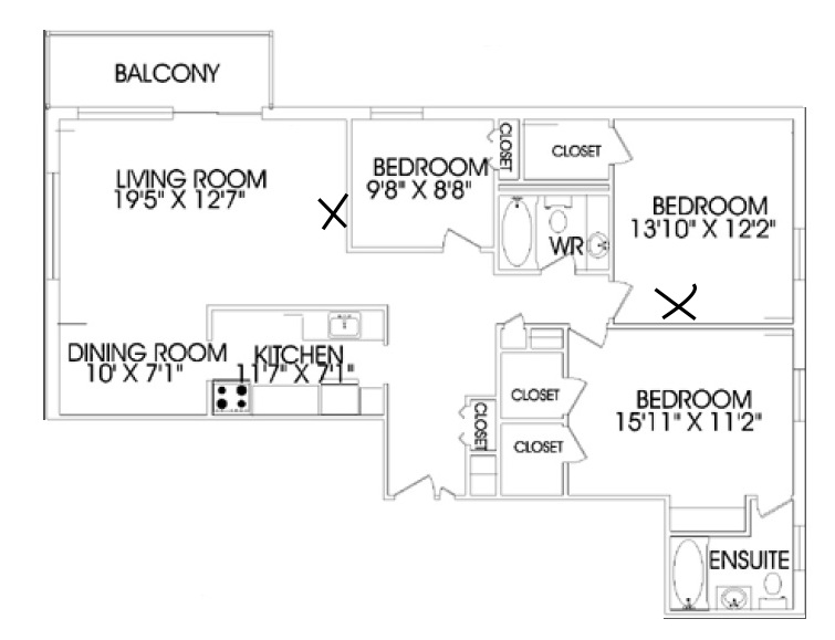

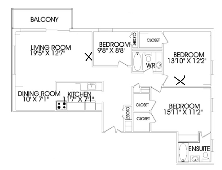

I'll see what I can do. The apartment has kind of a weird design which means I'd more then likely be running a wire across a doorway. Below is the floor plan of my apartment. The X in the living room is where the modem/AE is located (as well as the building cable line) and the X in the bedroom is where my Mac is located. The apartment building was built in the 1960's.

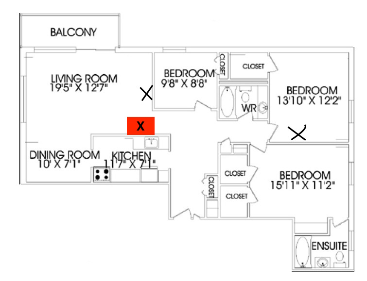

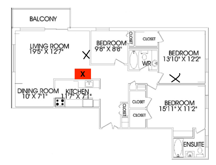

Are the router and the AE in some kind of enclosure or cabinet? If so, just moving them out of the enclosure or cabinet may solve the problem. If not, if not, can you move it to where I have put the red x?
A bathroom, with it's tile and plumbing, can often be a signal-stopper.
If you have enough cord you could at least test moving it as shown above to see if it helps (and I'd think it would).
Are the router and the AE in some kind of enclosure or cabinet? If so, just moving them out of the enclosure or cabinet may solve the problem. If not, if not, can you move it to where I have put the red x?View attachment 672690
I can do that but I'd be running the Rogers TV cable across that entrance way by where you put the X. There's no actual door way there. Just an opening into the living room. I could move the router around the corner from my X to the hall area on the adjoining wall.
Yes. moving it around the corner should help. Either that, or leave it where it is and run the AE around the corner using a longer ethernet cable.
