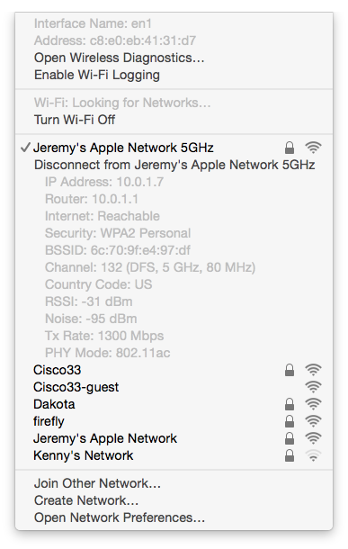

Most useful would be if you could connect to your normal router, opt click on the wifi and take a screenshot of the details shown. Then repeat when connected to the TC.

Really odd then. It's using AC and the 5 GHz channel. It's connected at max possible AC transmission rate. Your RSSI is pretty good when compared to mine right now (the lower to 0 the better on that scale). I don't see anything obviously wrong there, so there is no reason for such slow wifi speeds.
