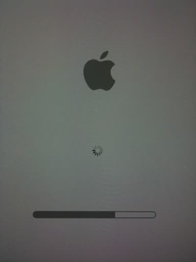

I burned Ubuntu Linux onto a CD and restarted my iMac while holding alt to boot into it. The CD didn't show up because I accidentally burned it as a data disc containing the ISO file, but my OS X partition is now for some reason displayed as "EFI Boot."
I selected it and it showed the usual startup screen with the Apple logo, then a spinning gear and a loading bar showed up under it.
It took 5-10 minutes to get past that screen, then OS X started up like normal. I tried ejecting the CD (which I did absolutely nothing with other than burn and leave in the drive) to see if that was what caused it, but it did the same thing when I restarted and it's still been doing it since.

The only time I've seen that bar was during a firmware upgrade, but that doesn't sound like what you've got going on at all.

Ok, if you're getting that boot support error from Disk Utility, that would sort of explain everything--something got munged up with the partition map, which is causing booting problems and could easily cause who-knows-what-else. Could've been Windows doing something to cause it, could have just been really bad luck.
Backup your data ASAP. Then if you've got an external drive with enough space clone the drive to it, wipe, reformat the internal drive, reinstall, reimport data. Doing a partition-only clone to a freshly formatted drive, then the same in reverse, might bypass the corruption, but I wouldn't take any chances with it--if the partition map gets hosed, everything gets hosed.
I also wouldn't be inclined to blame it on Snow Leopard--just last week I was working on a friend's iMac with that EXACT problem running on 10.5 (symptoms didn't include the boot selector, but did include everything else you're having trouble with except the weird progress bar).
The good news was, at least in my case, the drive itself wasn't bad, just corrupt, and after a reinstall and using Migration assistant to move the data back to the fresh install it ran perfectly. Hopefully your situation is the same.
[Side note: It occurs to me that maybe the progress bar in place of the spinner is new in 10.6--the "spinner" stage of boot is where the OS will run a disk check if something is wrong, and instead of sitting there indefinitely maybe they switched it to a progress bar to give some indication that it's doing something and prevent people forcing a reboot thinking it's stuck. It of course can't fix the problem, but it's still going to try--the one I worked on spent about 5 minutes on the spinner trying to fix the corruption before moving on.]

O ok thats good to know about the spinning in 10.5. I just figured it was snow leopard as a few of us are having the same problem but I guess it's hard to know.
