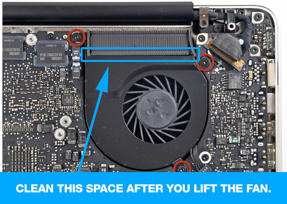

Hi,
So yes, as in the topic. If your MacBook is running slow from time to time, clean them.
In OS X under heavy load my mouse cursor tend to slow down and kernel process went over 100%. In Bootcamp Windows 10 under heavy load, MacBook was switching off (guess to prevent damage).
It's a MacBook Pro 15" 2011, with updated RAM to 16gb.
Unscrew bottom bit and unscrew the vents (without disconnecting the little vents power cable). And clean the air tunnels, you'll see them after lifting the vents.
I've missed it when cleaning my MacBook before. And what a difference it makes !
Please see "how to" online and be careful when cleaning.
Hope it helps someone.

Follow this guide: https://www.ifixit.com/Guide/MacBook+Pro+15-Inch+Unibody+Early+2011+Left+Fan+Replacement/5892
After you lift the fan, clean all the dust there. Not only the fan, but the vents, which allow the air to go out. If you never did it, you will notice that about half, 1/3rd of the vent will be blocked.

My Macbook pro 17" (the last week production machine) has been running like **** for the last 3 weeks and i had tried just about everything, even blaming Apple after they replaced my 4 year old logic board thanks for a dodgy graphics chip.
This morning the Kernal was running at around 450% and Ableton Live 9 was running at around 170%.
Took it apart tonight and cleaned out these fan vents...
This evening my kernal is at around 15% and Ableton at around 60%.
AWESOME!
