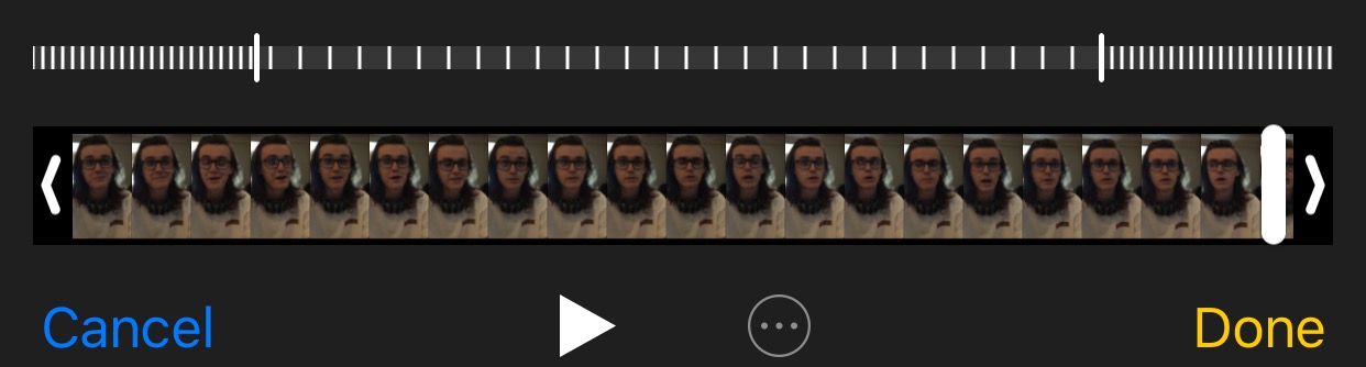

I just clicked edit, I do not see yellow sliders, though I do see what seems to be something different visually with the number of vertical lines beneath the video. There seems to be more vertical lines at the beginning and the ending of the video with fewer in between. It seems I can change this, though I am not clear on what it is doing?

Ok I've included a picture, the top bar you can move the sliders the bit in between the sliders plays in slow mo.
The slider below that is your timeline. This allows you to crop the video. Or move through the timeline.
