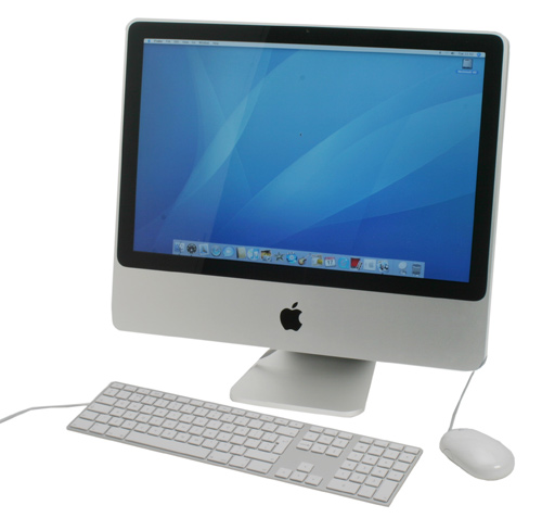

If it helps, the other iMac is on the original version of Leopard and is this machine:
