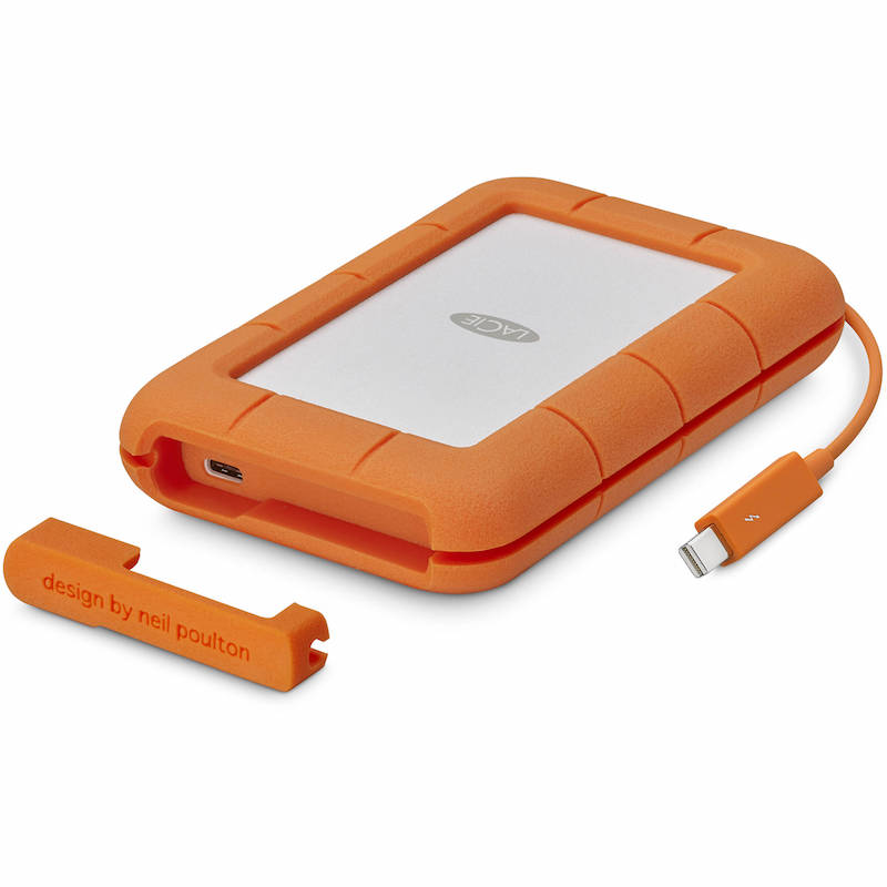

If you are going to connect using Thunderbolt it more than just a box and cable. The box has to have the circuitry for the interface and a Thunderbolt cable has a small circuit board in each end.
Thats why I suggest trying to get a secondhand 1TB LaCie Rugged Thunderbolt 1 drive. That has the required circuitry built in. It also has a fixed cable Thunderbolt cable. I got 2 of these drives from a secondhand store. You might be able to pick one up on eBay. Just make sure you get a Thunderbolt version 1 type.
thank you again. thats extremely helpful. I'll look on eBay now. So the actual hard drive in there will be an old sata or whatever & I swap that out for a SSD, right? much appreciated.
That is correct. You might be able to pick a 500GB version. The drive should look something like this.

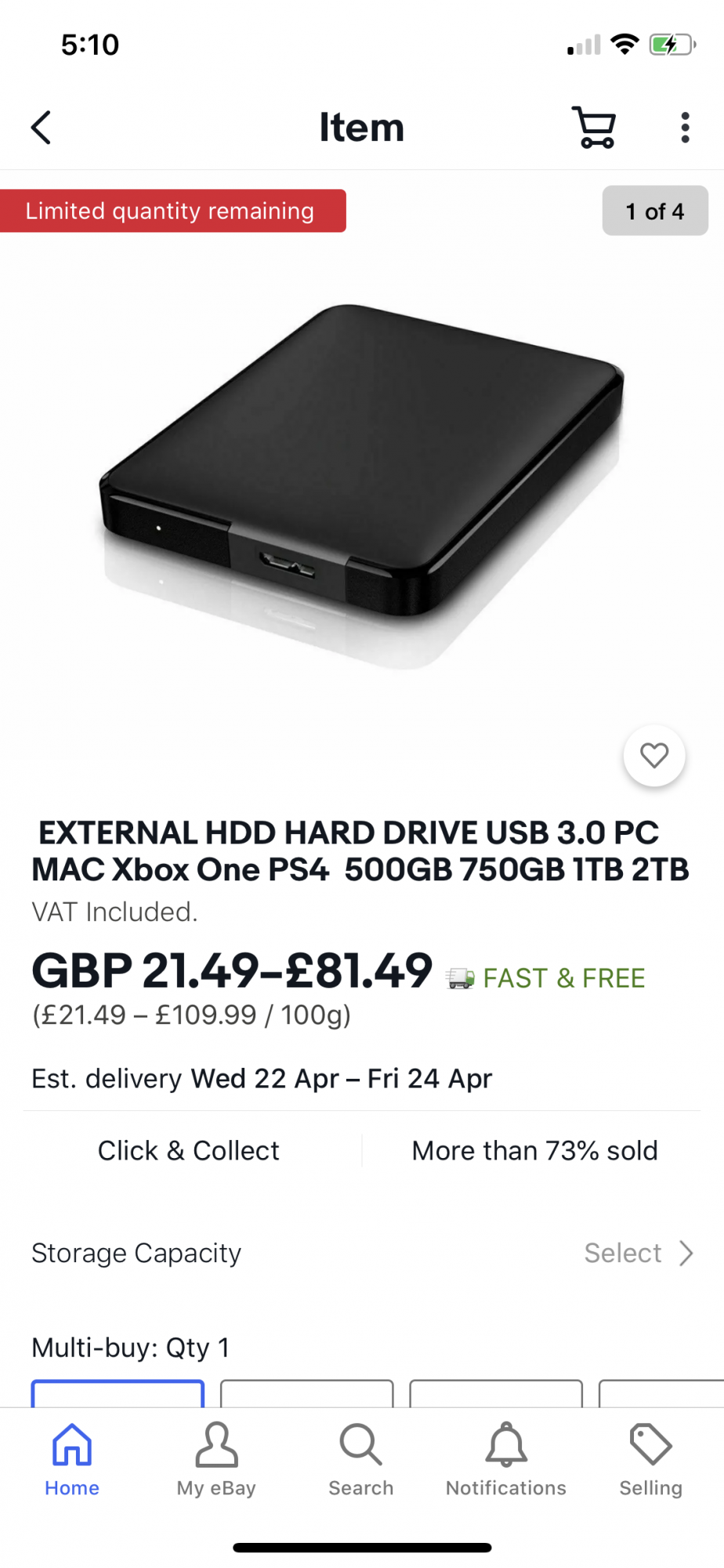

I have found this drive on eBay for £89.95. There are other 500gig SSD external that are cheaper. Do I need the Samsung for a specific reason or would any external drive work? There is an unbranded drive for £29.95 infact. (or 1TB for £45) do I simply copy the contents of the Mac drive (i.e. the data) just leaving the operating system on the Mac itself? I only have 300gig or so used on the Mac drive.
All you really need is a USB3 SSD.
It doesn't have to be Samsung, just about any one you buy will give the same results and speeds.
Just make sure it's USB3 and that it's an SSD (and NOT a platter-based drive!).

Does this one look ok? It’s USB3. I don’t know what HDD is. But below it says it’s SSD. SSD (500gig) is £70. Not much cheaper than the Samsung version.
And regarding the Samsung vs. non-Samsung drive: obviously it doesn't need to be Samsung specifically but since you will be connecting the drive via USB you are going to lose TRIM functionality. You should thus make sure to get an SSD with a decent built-in garbage collection. Such as for example Samsung's T5, which was designed for cases like this. Otherwise you might end up with an iMac that is just as slow was before after a few months.
Interesting. There seems little difference in price, ultimately anyway, so a slightly cheaper one may prove to be false economy.
