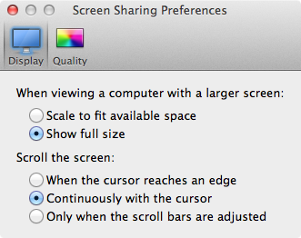

Slow Screen Sharing. . . Scaling
Hello,
What is scaling? Where is this option?
In Screen Sharing Preferences:
Reactions: mrdoodle
Thanks, I find the feature but the issue is still there.
