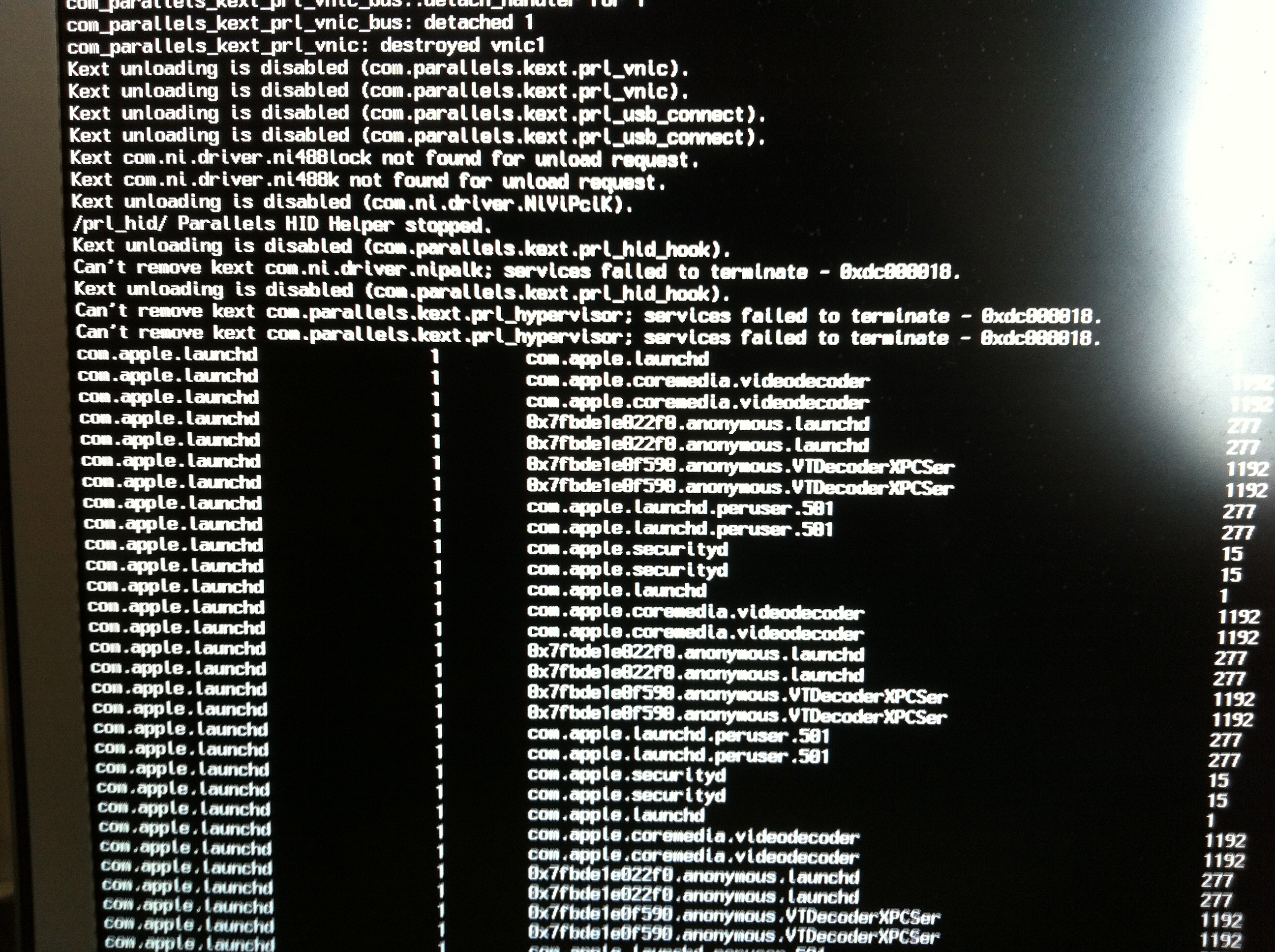

I'll switch my computer to boot into verbose mode to see if I can spot the culprit.
In verbose mode at shutdown my main culprit seems to be:
com.apple.securityd
Anyone else?

In my case, Parallels is having some problems, but I'm not sure if that is the cause. You can see all of the com.apple.launchd stuff below the Parallels errors, which is where it spends the majority of its time. It will spit out a batch, then stop for about 5 seconds, then another batch of them, and stop, for about 4 times.
If you notice, they're all the same PIDs and services. I'm not used to debugging OSX, so I'm unsure if that is related to the Parallel's errors or not.
Maybe someone with more experience can tell me?
