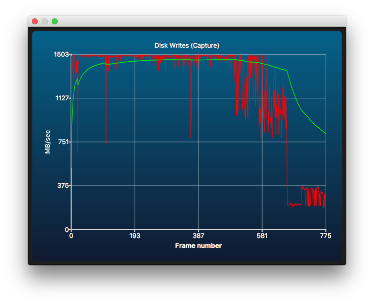

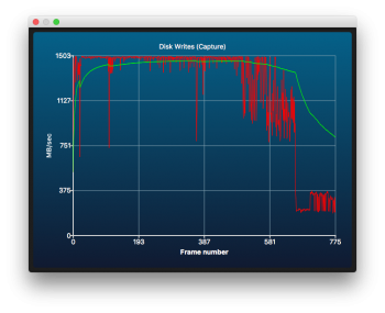

This is my first post. I'm running a MP 5,1, Sierra, booting from a Samsung SM951 (512GB) blade mounted to an Angelbird PX1 card in slot 3. Aja performance test shows 477 MB/Sec Write and 1443 MB/Sec Read. The write speed starts off at around 1000 MB/s and then when 3/4 full (I'm running a 16 GB test), it slows way down at then end. Is this normal behavior for this blade? Do these blades slow down as they fill up? I've got 54.71 GB available.
I've attached a image of the Write speed. I drops suddenly towards the end of the test.

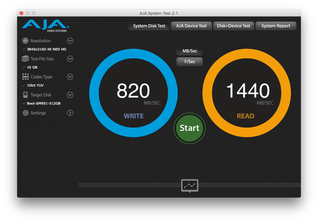

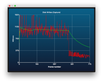

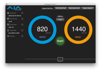

I ran fsck -fy as tsialex recommended and it did seem to help, but didn't bring the SM951 to full speed. Perhaps that's just how it is when it's this full.
Thanks again. I guess my next step is to look for a bigger blade (since I'm getting full) or keep this one as a boot blade and get an NVME one for scratch/storage.

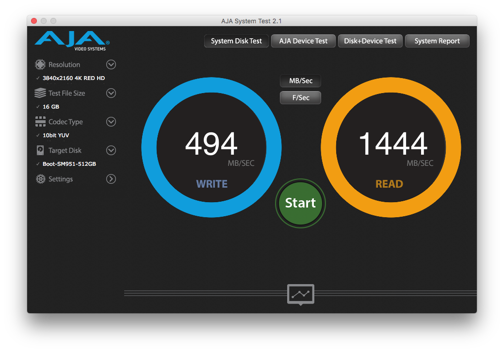

Well, that didn't last long.....after a few days, I'm back to 494 MB/Sec write times.
How often does one have to run this force trim code on the SM951?
Maybe it's time to just buck up and replace with an NVME card, but that involves upgrading to Mojave, which requires, updating the boot rom and a new gpu, and...... sigh.
