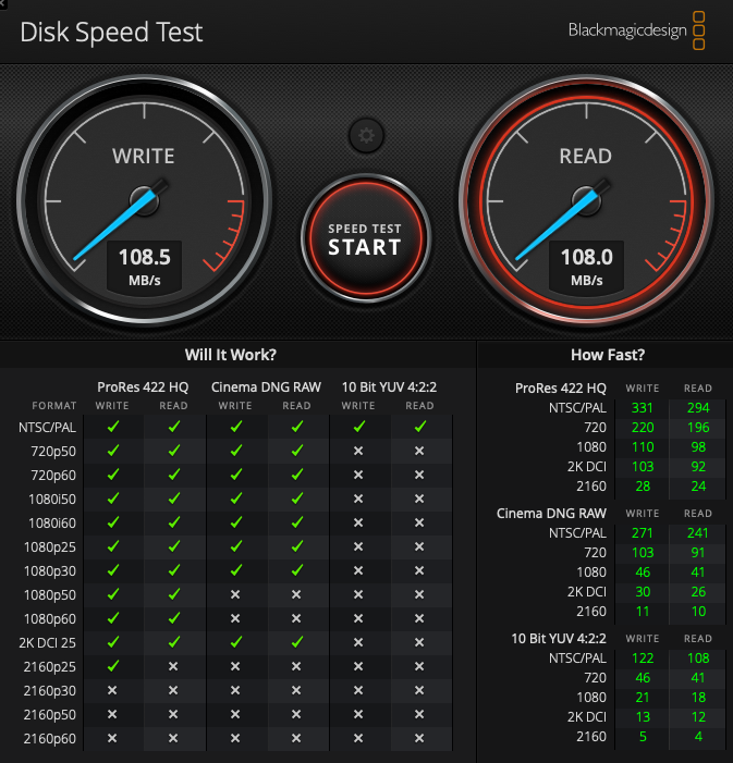

My network is hardwired cat 6 throughout it house I deployed, runs into a patch panel and to a 24 port GB switch. The time machine backups are going to a Synology NAS with a bonded network and normally its pretty fast transfer rates. However, when I tried to restore my wife's account (far less data) it would only transfer at 7-8MB/s and took over 12 hours. I have far more data to transfer than her but I don't want to start it until I can figure this out, I even did a disk speed test over the network to the TM backup folder ran a little over 100MB/s so I am not sure the problem. also I have 1GB internet speed but that's WAN and it has nothing to do with the LAN speeds. here is a pic of the test on pretty full drives (89%), I'll be upgrading my NAS soon to either the DS920+ or the QNAP x53D 6 bay.
here's a screenshot of disk speed test over the network

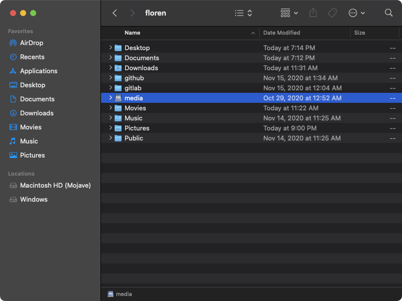

The end-result is a /media directory mounted permanently into my User directory, with no auth nags upon a restart etc.:

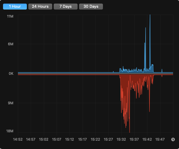

This is my TM HDD usage in the last one hour

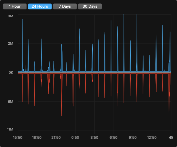

And this the the usage in the last 24 hours

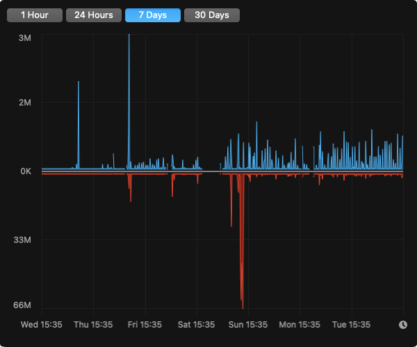

This is the last 7 days
Apparently, after Big Sur update, there was a relatively large backup, and the speed is fine. But for most of the time, in my case, there is no large files to backup. And the backup speed usualy stay below 10MB/s
