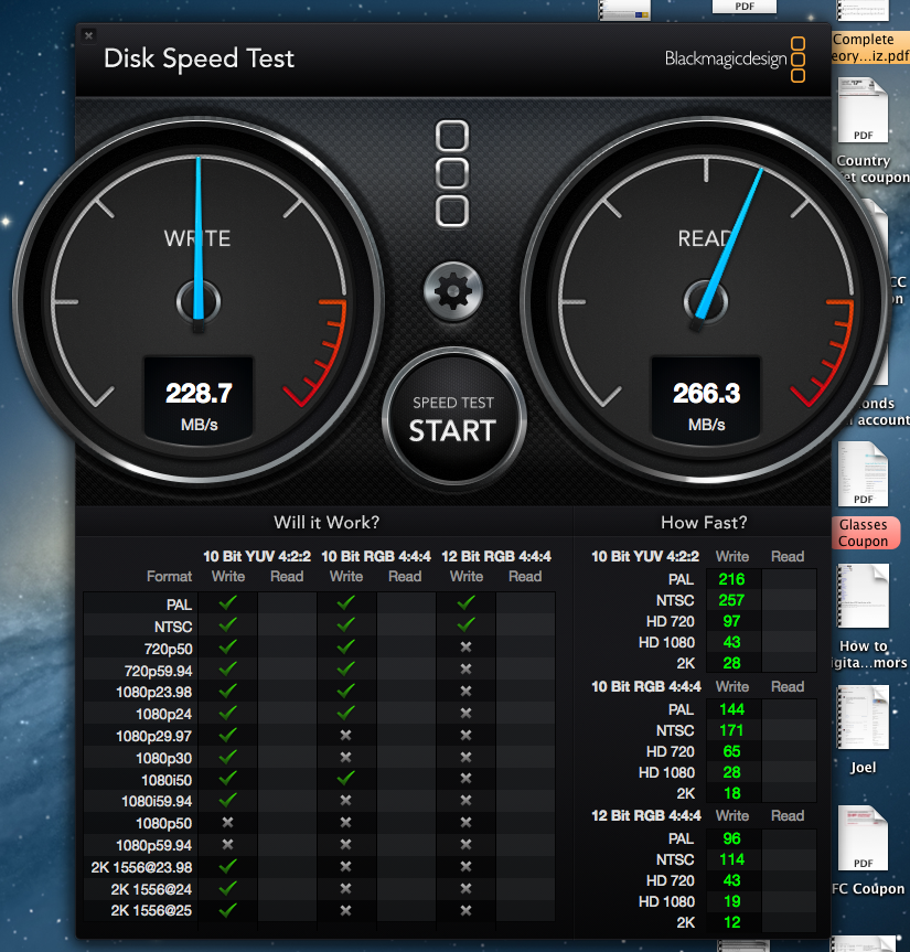

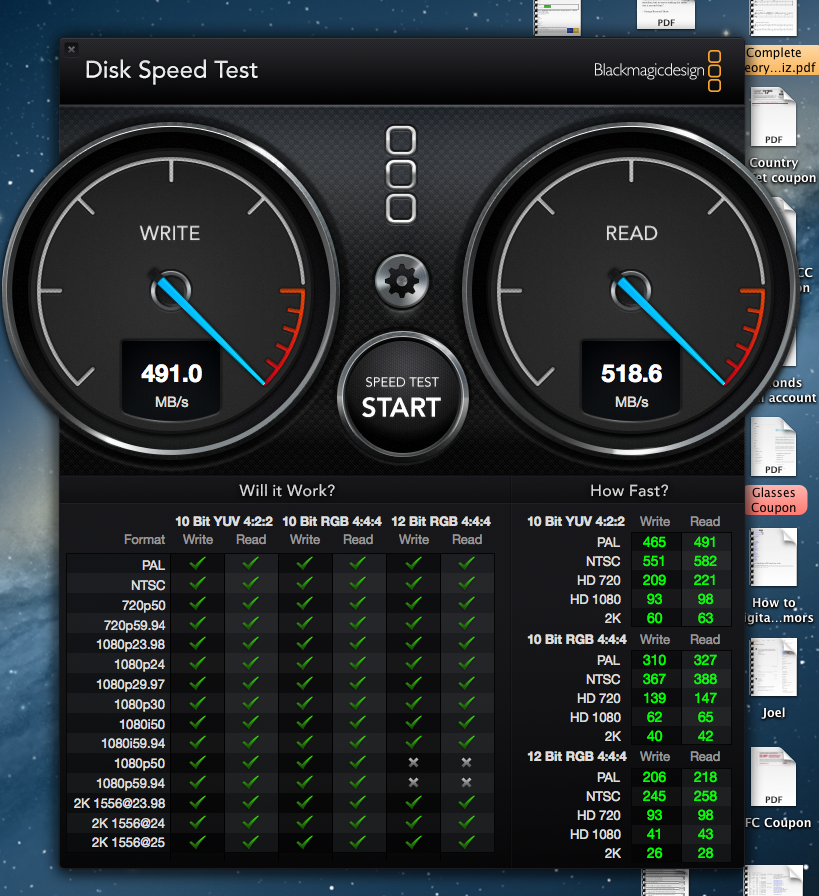

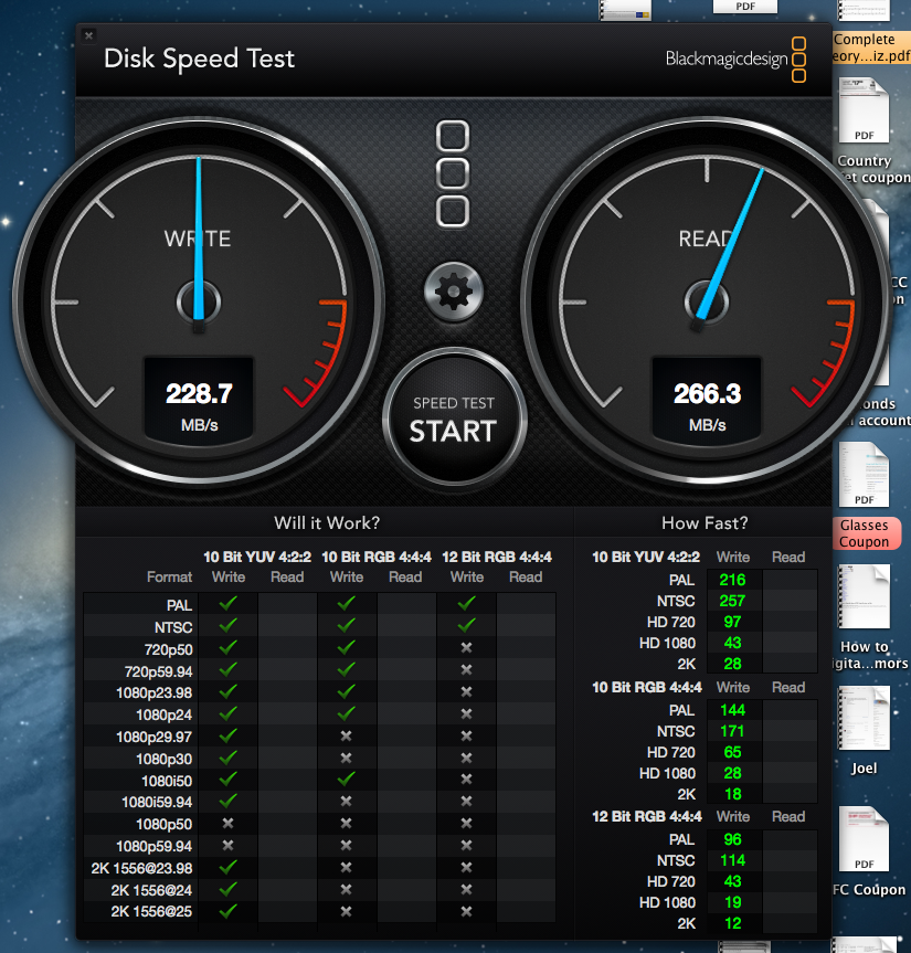

I installed a Samsung 840 Pro on my 2012 Mac Mini server and was so impressed with the speed that I replaced the two smaller SSDs (Raid 0) in my LaCie Little Big Disk (connected using Thunderbolt) with 840 Pros as well.
I installed Black magic design's Disk Speed Test and expected to see high from the array. What I saw was just the opposite.
I use Trim Enabler on all of the drives.
There is 281.13 Gb of space remaining out of 1 TB.
Any suggestions as to the cause?
(I'm including a test of the Mac Mini's drive as a reference.)

If you used a older hard disk LaCie Little Big Disk TB enclosure for your SSD RAID-0, you may actually have SATA II inside, and the firmware is optimized for hard disk usage which slows it down.

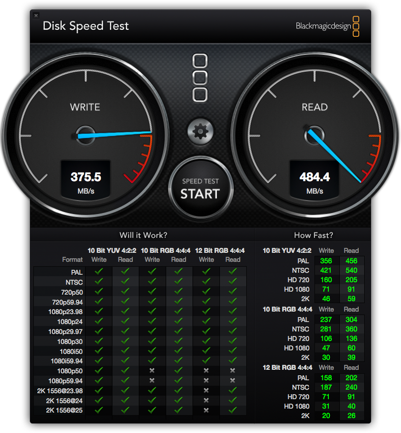

However, your speeds do seem abnormally slow even with this consideration. Here is a DiskSpeedTest of one of my "old" LittleBigDisk TB enclosures with a pair of SSDs (I think Crucial M4) in RAID-0:
(Using 840 Pro SSDs should produce about the same read speeds, but with higher write speeds close to the read speed.)
It shipped with two SSDs.
Agree with above - it's more than likely a SATA II interface, so at theoretical best you could get 300MB/s, so those results look about right.
Was that an LaCie oem SSD product, or somebody modified one?
If it is the newer black LaCie LBD TB2 with 1TB in RAID-0 SSDs, it should be blazingly fast ... something is wrong!
It was their first version. It was on sale - cheap - at Best Buy. Now I know why.
