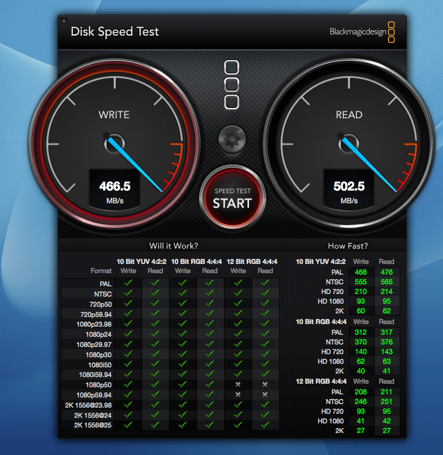

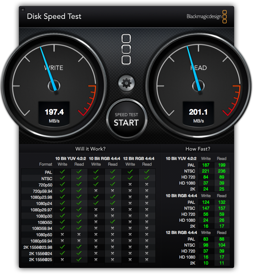

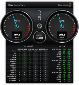

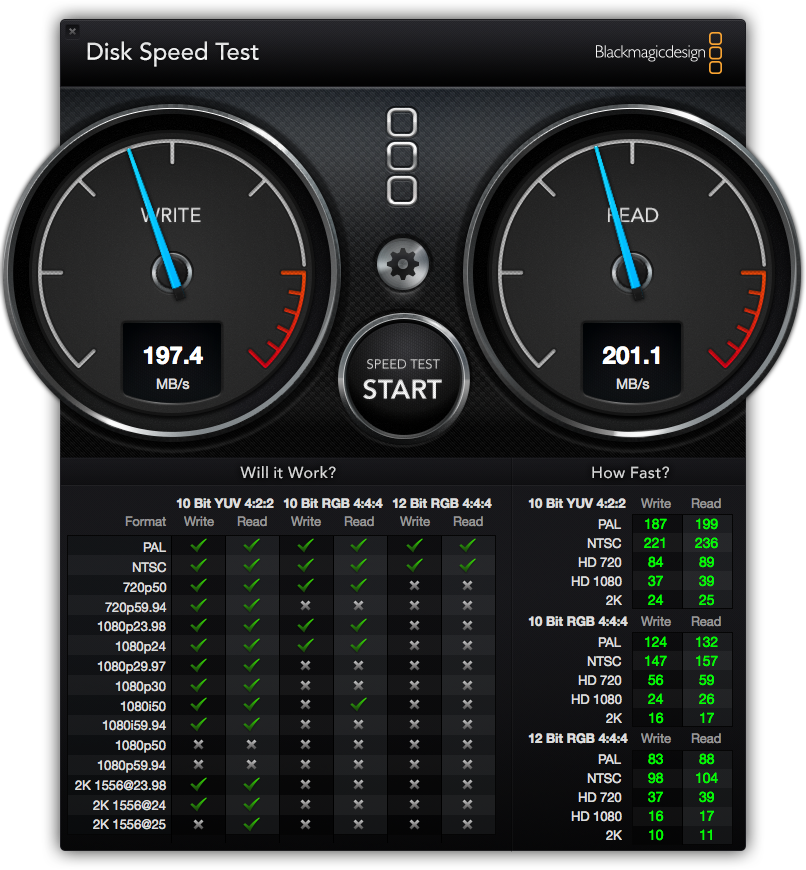

You don't mention which size of Thunderbolt LaCie Little Big Disk you have, but I have a couple of them and did some measurements awhile ago. Shown is the test on a 2TB (dual 1TB hard disks in RAID-0 as received), and a test after replacing the hard disks with a pair of SSDs in RAID-0. These were probably tested on a 2012 iMac 27" at that time. Another LBD came with 1TB using a pair of 500GB in RAID-0 and tested somewhat slower at 154/153.

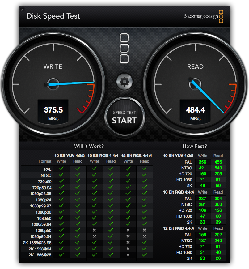

Well to give you some comparison I installed (albeit internally) an SSD alongside the existing HDD a couple of weeks ago - mid-2011 21.5" iMac (daughters machine). These are the results - SSD is Samsung Evo 850Screen Shot 2015-06-24 at 09.32.12.png

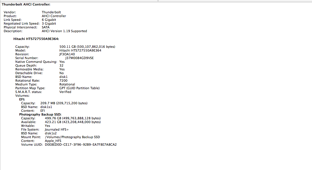

Those are speeds closer to that of of spinning hard drives. Does Disk Utility or "About This Mac" > Reports > show that the LaCie has actual SSDs in it? Older Little Big Drives were sold with the spinning disks.
Ahh. Called Lacie (GREAT customer service btw). Gave them my serial #. Turns out this particular external is in fact a rotational drive vs. SSD (bought from a friend, so always assumed all LaCie were SSD. Thus the slow read/write times. I'll reformat this and keep as a storage device and start looking into adding internal SSD to the iMac. Thanks everyone.
