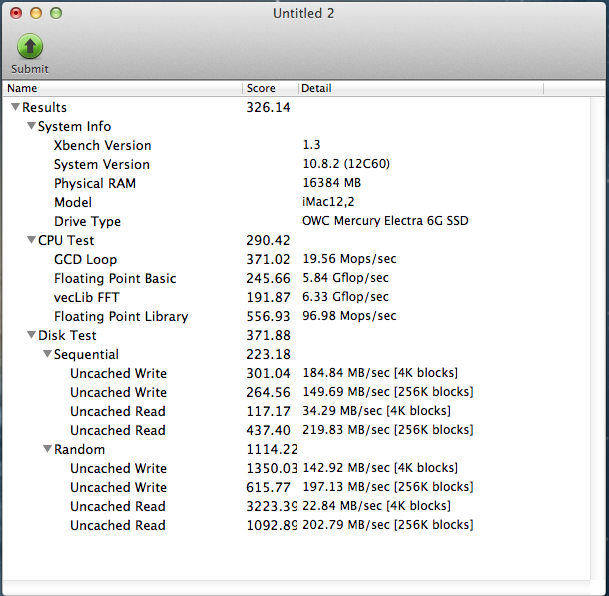

Here are test results from Xbench as well. While the speeds are better than I am used to with an HDD, I didn't spend almost $200 and 2 hours of my time for such a marginal gain in performance, especially when others are getting much better speeds with the same hardware.

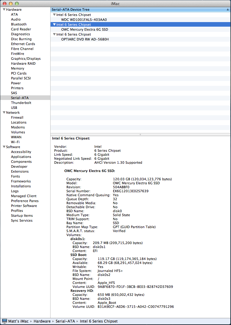

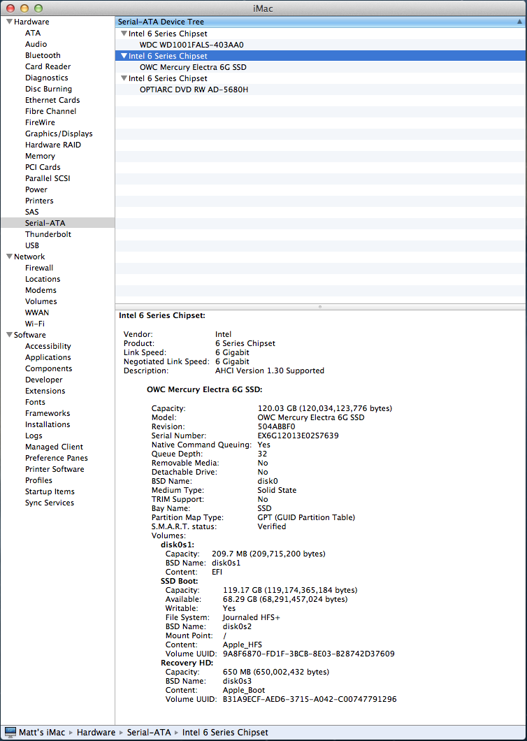

Ok so I looked at my link speed and it's showing the same 6 gigabit negotiated link speed as my macbook air's. The only difference I see in system information is that on my MBA it says "Product: 7 series chipset" and on my imac it says that it is a 6 series. I don't know if this is in any way relevant though. I attached a screen shot of my imac's info.

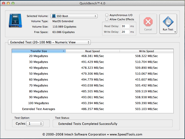

Ok so I contacted OWC tech support and they sent me SpeedTools Utilities and said to use QuickBench because that is their benchmarking tool. After running the test, my results are dramatically different than what xbench and blackmagic showed. I attached a screen shot of the new benchmarks. The numbers definitely look better but I'm still perplexed as to why two other programs are showing far slower speeds.

After emailing with tech support, they told me that "BlackMagic and other software tools will use different testing parameters, most of the tests done through the software is testing incompressible data and other professional data sets".
So if I am interpreting this correctly, he is saying that the Xbench/BlackMagic scores are lower because they use incompressible data and QuickBench does not. This seems to make sense because the numbers I posted yesterday are seemingly consistent with the incompressible data rates listed on OWC's website. However, I don't see why the benchmarks on my Air are so high using the "professional data sets"
What OWC told you is correct regarding their Sandforce controllers (which compress write data for better performance) and testing with non-compressable data. If you try the AJA test (also free), you will see much better numbers in the disk test. Whether the higher numbers will actually improve your experience using the SSD will be determined by what you are actually using it for.
