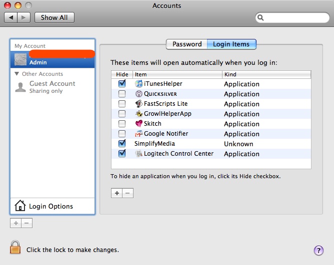

What about your login items?
Everything else seems to be running just fine. I did try and update a few things with the software update and it froze on me about 30 mins ago. But I forced it to quit and restart and it was fine. Still having the slow start up and shut down issue though. The updates weren't anything major for the operating system though. I think the only one it got through was one for support for some digital cameras.
ETA: Sorry I didn't see the image until I submitted the reply. I don't have anything set to start up when I log in.

I'm surprised it didn't fall in under a Login item. I've found that printer's install buggy startup background processes quite often.
Well I had installed the printer and then I uninstalled it when the problem started. Then when I still had a problem that's when I made the first post. Then I went into the accounts and under my name like your image showed and there was only an itunes help thing which I didn't have checked because I don't want that starting when I turn on my computer. So it wasn't listed there.
