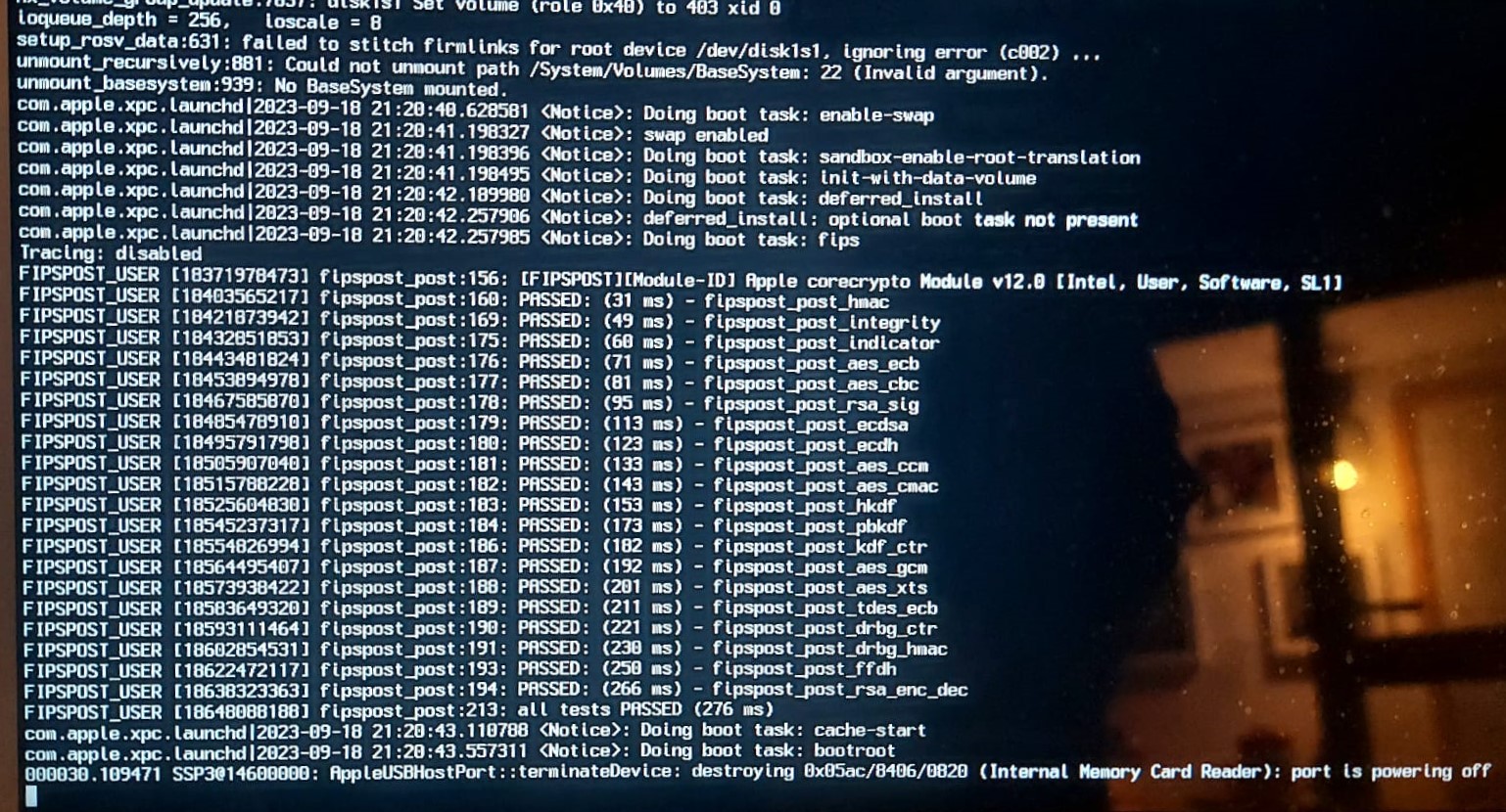

Boot with Command and V held down and see where it hangs up. Could give you a better picture of whats causing it.
there are few point where it hangs a little but where it hangs more is athe the last 3 lines..first at the end of the 2 com....
thena a wile after the last one
You wouldn't happen to have an aftermarket SSD installed would you? Those are indicitive of trim issues commonly found with NVME adaptors with Monterey.
that's it! i have an aftermarket with adaptor.But it worked good for more than 1 year. Can i upgrade to the next macos other than monterey?
Monterey is the last officially supported version of macOS that can be installed on the 2017 Air. So, two options: Either install OpenCore Legacy patcher to enabled unsupported macOS versions OR change the drive out with a known working NVME controller. Intel/Crucial/Western Digital SSD's work great, just stay away from Samsung's.
so may be with a fresh install could solve..dont want spend now more money for the disk... i mean if the mac was unusable yes..but, for now, it is just a slower boot..not never ending
