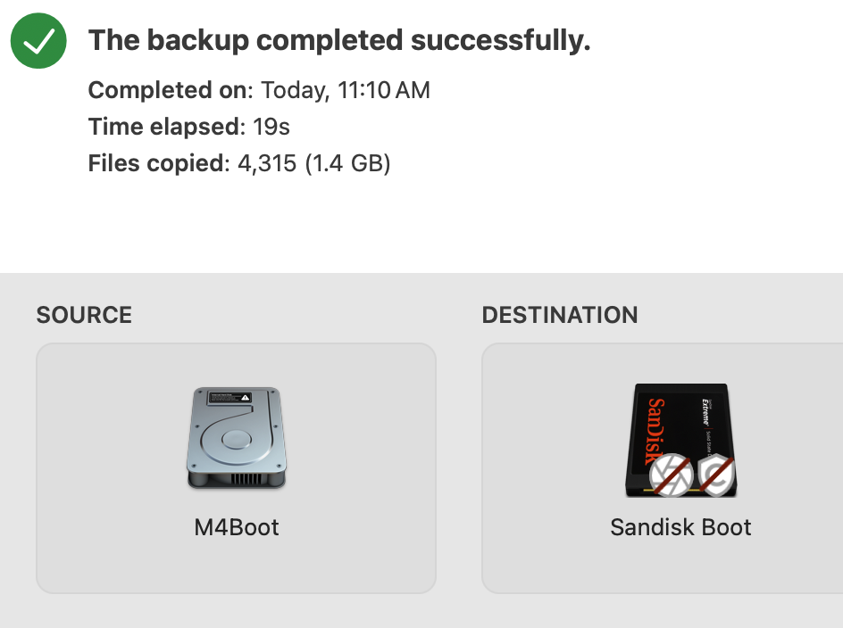

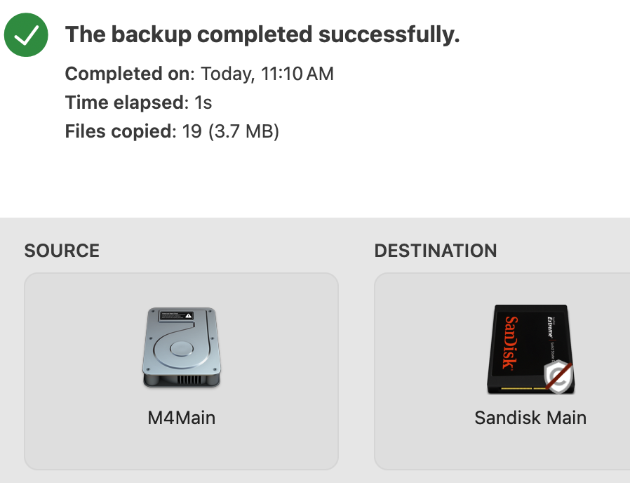

I'm using CarbonCopyCloner on a Mac Mini (m4), OS is 15.5 "Sequoia".
My backup drive is a Samsung t7 "Shield". This is a USB3.1 gen2 speed SSD.
My internal drive is "split" into 4 "hard partitions" (NOT APFS "containers").
Boot (accounts & applications)
Main (general, personally-created data, many small files)
Media
Music
For this thread, I'm going to run a backup of the Boot and Main partitions right now.
(be right back).
Boot backup:
Main backup:
Is that "fast enough" for you?
