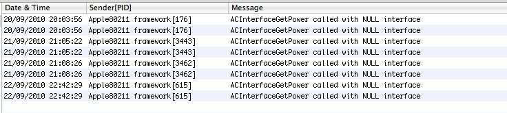

I'm back bearing bad news. I have tried what was suggested, and I have just experienced the problem. I jumped straight into console to see if there was anything there, and I see an entry that seams to coincide with each time its happened.
I don't know if its related, but the error looks serious.
Just a shame that the nearest Apple Store is 50+ miles away 😡
Craig

It would seem that 'serious' error message, just means os x has fouled up it's network assignments (i.e it think en1 is en2 and en0 is en1, so it thinks it has 2 airport cards and can't make the correct hardware call)
Ditch the NetworkPreferences.plist and/or com.apple.airportPreferences.plist files which sit in /Library/Preferences/SystemConfiguration
Restart, OS X will recreate them by polling the devices and hey presto 🙂 You'll be up and running again!
It looked serious lol 🙂

I have just finished my format/re-install. Not installed any additional software, and I had the ACInterfaceGetPower called with NULL interface entry waiting for me.
So this definatly is now hardware issue?
