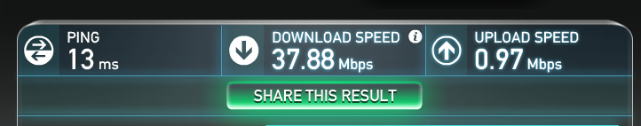

The thing is even when I am right beside it I have slow internet. Could the router be broken?

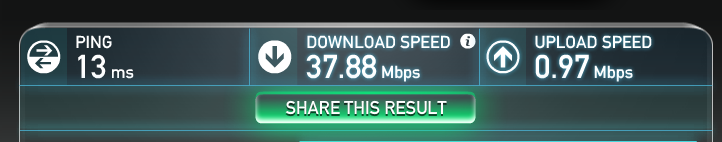

Hi Everyone!
So basically this weekend I was trying to stream a video that was 7gb from our server. I was unable to do this. My wireless internet speeds ...
1st lets put things into perspective... These speed tests ... basically all of them ... Have a fatal flaw that ISPs take great advantage of, the test is not very long and as such ISPs can and do tweak their networks to ... Test Well ... they give you an initial burst rate for a fairly small amount of time that presents really well when tested. The down side is once a download speed is kept going beyond the burst time frame the speeds drop .. Often drastically. Look at the cable speed chart that Netflix publishes .... Those numbers are FAR below what most people see with a very short term test.
2nd you seem to be trying to stream from INSIDE your home... If this is the case then those speed tests mean nothing since you aren't traveling out to the net in the first place.
Now if your server is connected to 10 base T hub then 10mb/s is all you'd ever hope to see.. Actually slower but you get the point.
What you need to do is trace the data path...
Like iPod Touch 54mb/s to xyz base station with 100 mb/s connected to a 10 mb/s hub to a server connected to that same 10 mb/s hub to the servers gigabit Ethernet port.
In the above the lowest speed of 10mb/s is the BEST you could hope for .. Again less really.
Now if you had a 100mb/s HUB even then it being a HUB means the 100mb/s is SHARED between each port on the device.
If you had a 100mb/s SWITCH or gigabit SWITCH then you'd have a much easier time doing streaming. However remember that wifi is a shared service so just by having multiple devices active on the same wifi network will always be worse than only having a lone device connected to the device.
