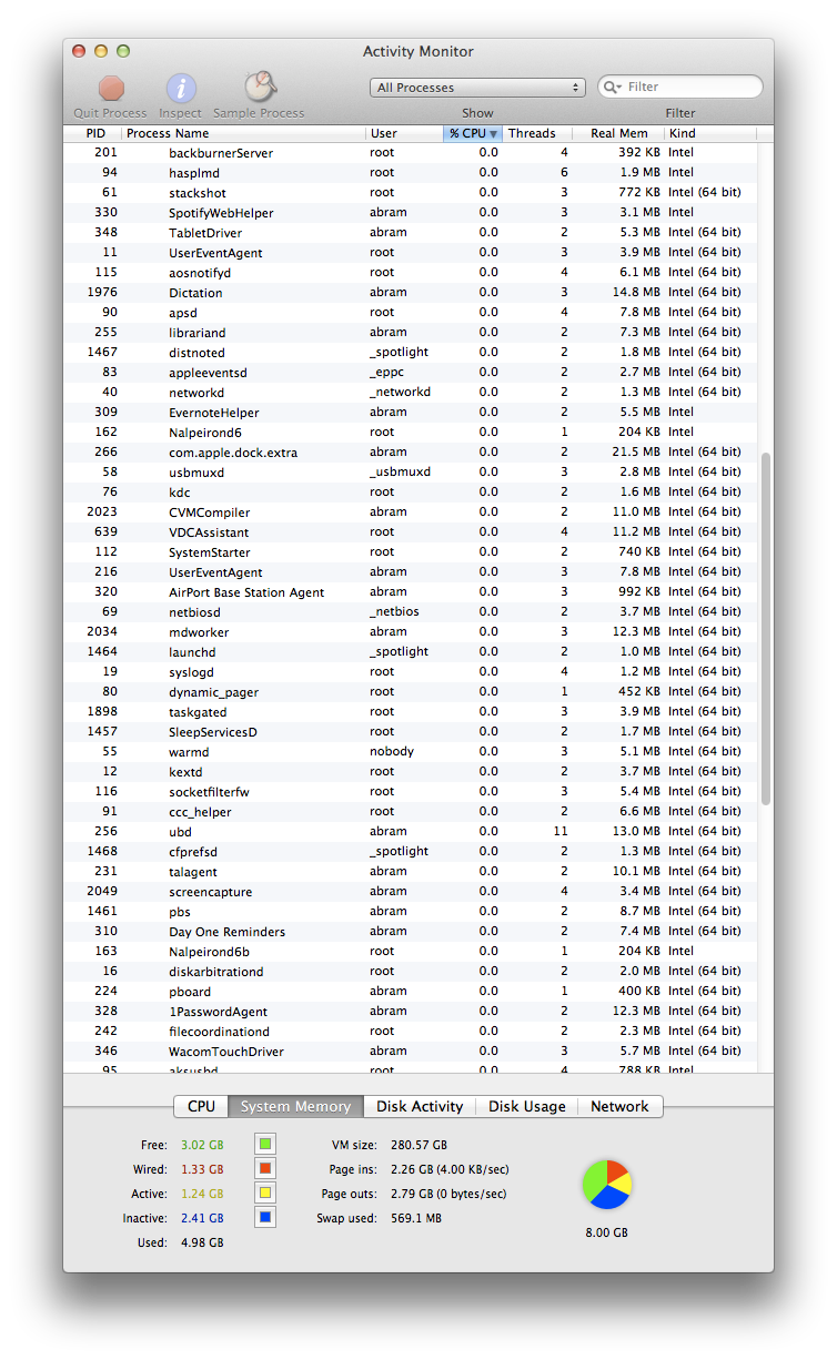

I've been experiencing a similar issue (I hope I'm not hijacking here, I didn't want to start a thread for the same question)
On my '12 MBP 15" I bought the 2.7 i7 model which came with 8GB of Ram, the 1GB nVidia 650m and a 1TB 5400rpm HDD. In overall use the computer was pathetically slow. It was no faster to run or open any application than my 6 year old 2.66 Mac Pro I just replaced with this MBP. I was also experiencing repeated Kernel Panics which was later diagnosed as Chrome causing the problem so I removed it. No more KPs thankfully.
I would describe myself as a heavy user as I use a lot of media editing software (Lightroom, Photoshop, Illustrator, Premiere Pro, etc. etc...) for both work and school. I was seeing enormous page outs which would accumulate quite rapidly under my workload even with 8GB of Ram and only running one of these media apps at a time. I would have to restart my computer ever few hours just so I could use it.
I have since replaced the boot drive with a Crucial m4 256GB SSD which has helped significantly with launching and running my software and there is noticeable improvement overall. That being said I am still experiencing a lot of page outs though it doesn't cripple my computer quite as bad as it used to. Until I use more than one "heavy" application at a time then it's toast.

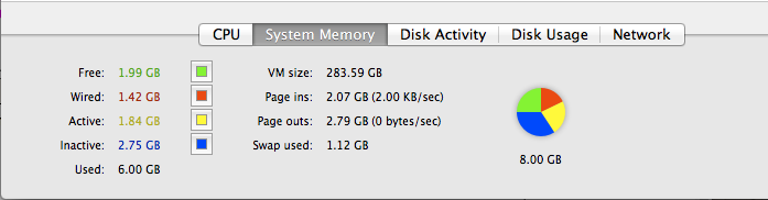

For example, after a reboot yesterday, I presently have more page outs than page ins on Activity Monitor, is this normal? I did order 16GB of Ram from Crucial as their sale price brought it down to a mere $77 and I figured I couldn't say no. Hopefully that will help resolve the issue, but I really want to get to the bottom of this.
I just took the attached screen shot a few minutes ago while my MBP is running only Safari and Mail.
Thanks for any help or advice you can offer.

Follow every step of the following instructions precisely. Do not skip any steps.
  1. Launch Activity Monitor
  2. Change "My Processes" at the top to "All Processes"
  3. Click on the "% CPU" column heading once or twice, so the arrow points downward (highest values on top).
    (If that column isn't visible, right-click on the column headings and check it, NOT "CPU Time")
  4. Click on the System Memory tab at the bottom.
  5. Take a screen shot of the entire Activity Monitor window, then scroll down to see the rest of the list, take another screen shot
  6. Post your screenshots.

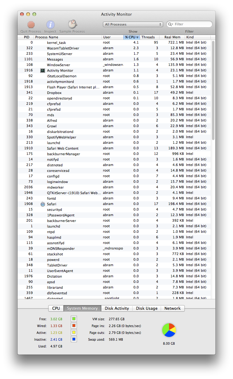

Ok here is my Activity Monitor screenshots.
There's nothing in those shots that indicate high memory or CPU usage, and you have plenty of memory available. Try taking screen shots again under your normal workload, while running one or more of those media apps you mentioned.
