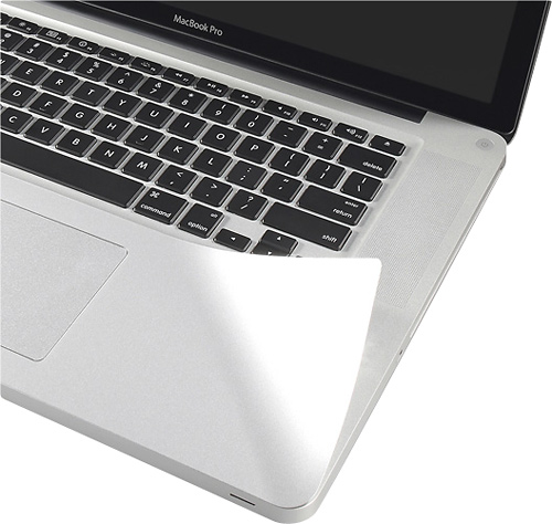

People say it's because of the sweat from your palms that's causing the wear. I think the only way to truly protect your MBP is to buy and apply those protectors. I have it on mine and it does bug me a bit (MBP1,1). I just live with it for now. I think I only got it because I gamed so much on this MBP. Ever since I stopped gaming so much, the problem has not gotten worse at all. I know this isn't an option for you, but I think I can buy a whole half of the MBP (very expensive though) and replace it

Cheapest solution is to buy a pack of ID lamination sheets, the peel and stick kind. Cut out to match the palm rest area and carefully apply. I put one on my laptop in 2005 and didn't have to replace it until 5 years later. Cheap and durable.
