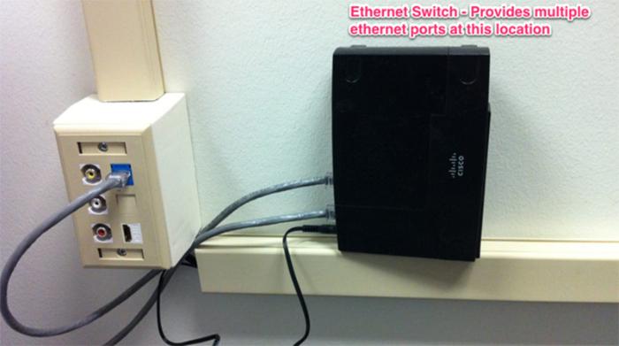

Run 1 cable from your internet router out to the gigabit switch. Then 3 cables out of the switch to the two workstations and the server.

I'm about to order a gigabit switch, but just to confirm, I can run ethernet from my router to the switch and then that switch will distribute the internet to all the macs? Sorry if it's a stupid question, but trying to get my head around the difference between a router and a switch. Budget is not a problem as my company are picking up the bill. Any advantage over buying a more expensive switch?

You are correct - set it up as you describe. For your purposes a cheap switch (e.g. TP-Link) will do. I picked up an 8-port gigabit switch for somewhere between $20-30 a few years ago for a setup similar to the one you're proposing a few years ago, then later had the house wired throughout with CAT-6 (requiring a 24-port switch).
