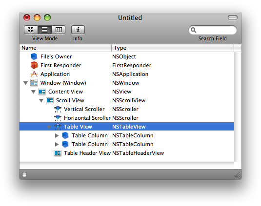

It is slightly easier to work with, but they do have a hierarchical view:
Oh man, nice! I've been holding off on upgrading to Leopard because my work won't upgrade yet (big company beauracracy + IT security paranoia), but the new dev tools and Time Machine are making it hard to wait. Thanks for the pic.

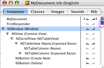

In Xcode old version you can navigate the hierarchical tree like this:
