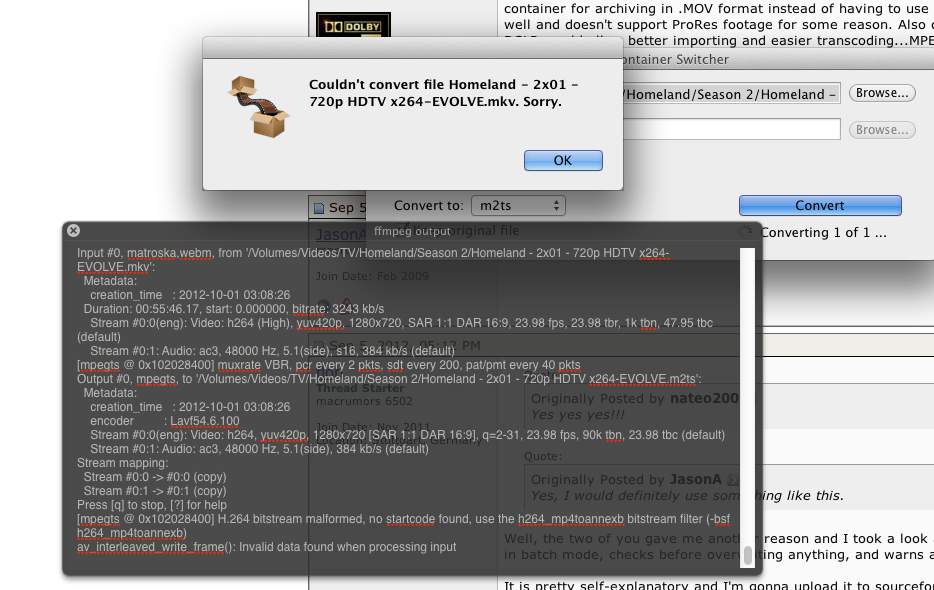

Hi. Just came across your program. Tried running it and keep getting errors trying to convert mkv files to m2ts files. Screenshot of error is attached. Any ideas?
tried it with 6 files I have and none of them were processed
thanks
thanks
Do you mind if I ask where the files originate from? The error message looks to me as if the original file actually is an H.264 codec, but the startcode (0x0000001) before the first keyframe is missing. This can happen if you for example record from a tivo or television in general and the recorder doesn't start at a proper point in the stream.
An .m2ts file is less relaxed when it comes to accepting streams than an .mkv file, it needs this keyframe information. Therefore just copying the stream results in an error. You will probably have to automatically add some information to the stream. This is kind of a re-encoding, but not really since you don't use quality. It is rather called re-muxing.

thanks for your help. these files were downloaded, not sure where they came from. basically what I'm trying to do is to convert stuff i download to m2ts format so that it plays fine via my windows media center extender. Extenders don't support mkv files natively
let me try in one file via terminal
just tried coverting through terminal and it seemed to work fine. took less than 10 seconds
