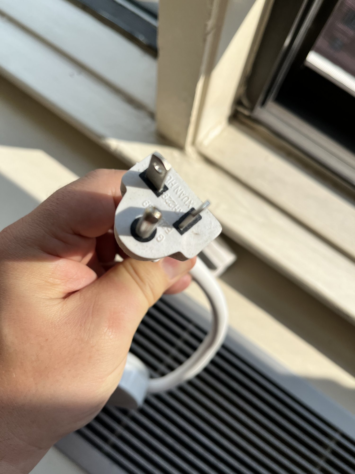

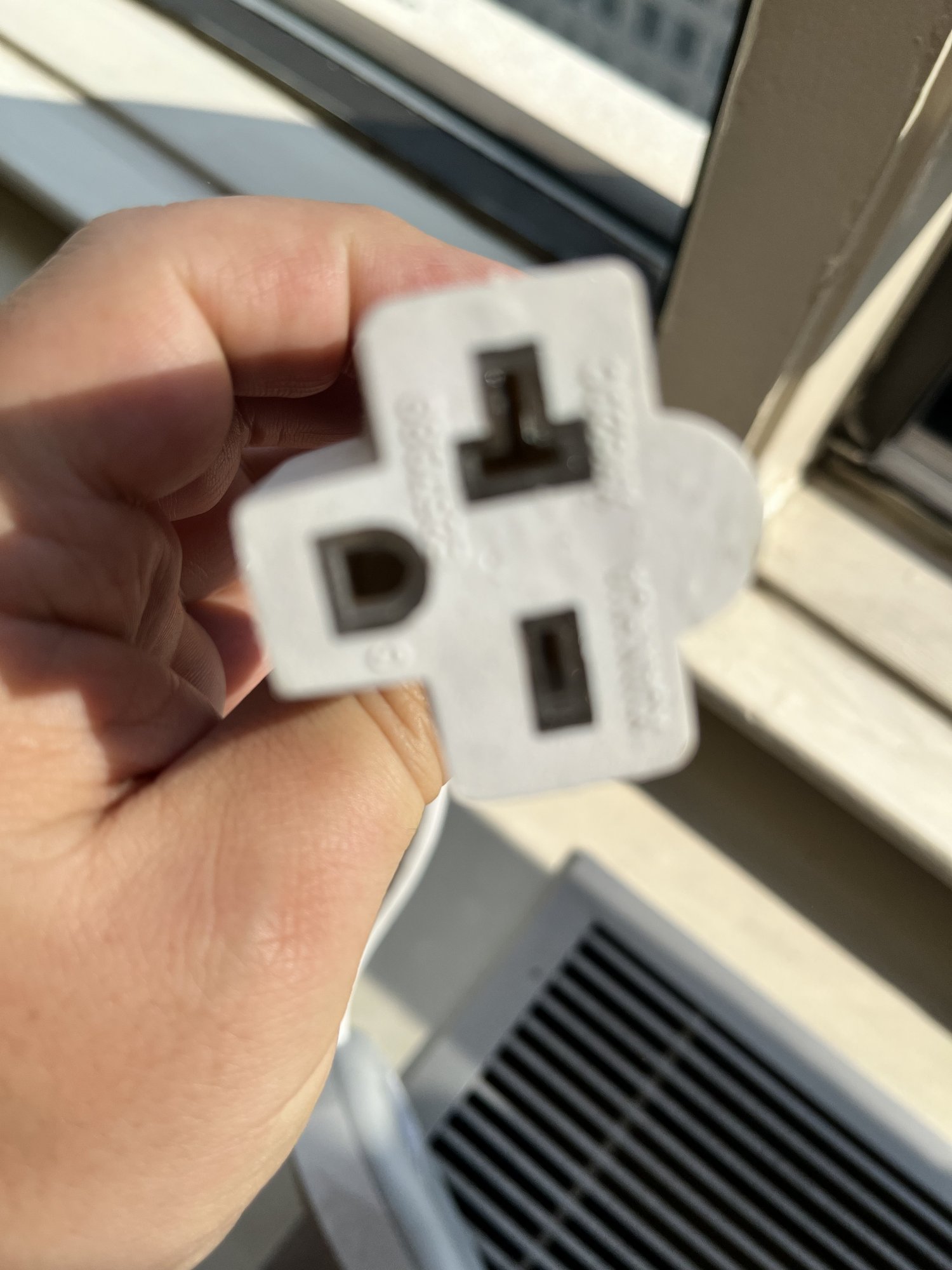

I've been searching everywhere on line, and really surprised I can't find a smart plug for this design of an air-conditioner plug. I don't need a thermostat or anything fancy like that; just hoping for remote on/off functionality and, ideally, scheduling.
Does anyone have one to suggest, or know where I can find one (or three)?
I’m not seeing any plug-in type adapters for a 20A outlet - the only option I see is to replace the outlet itself, e.g. with this.
