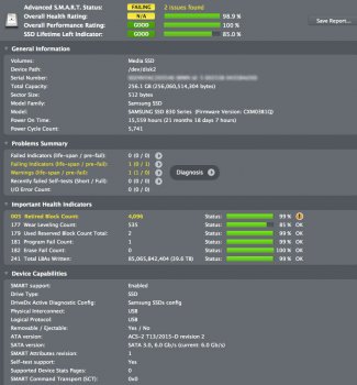

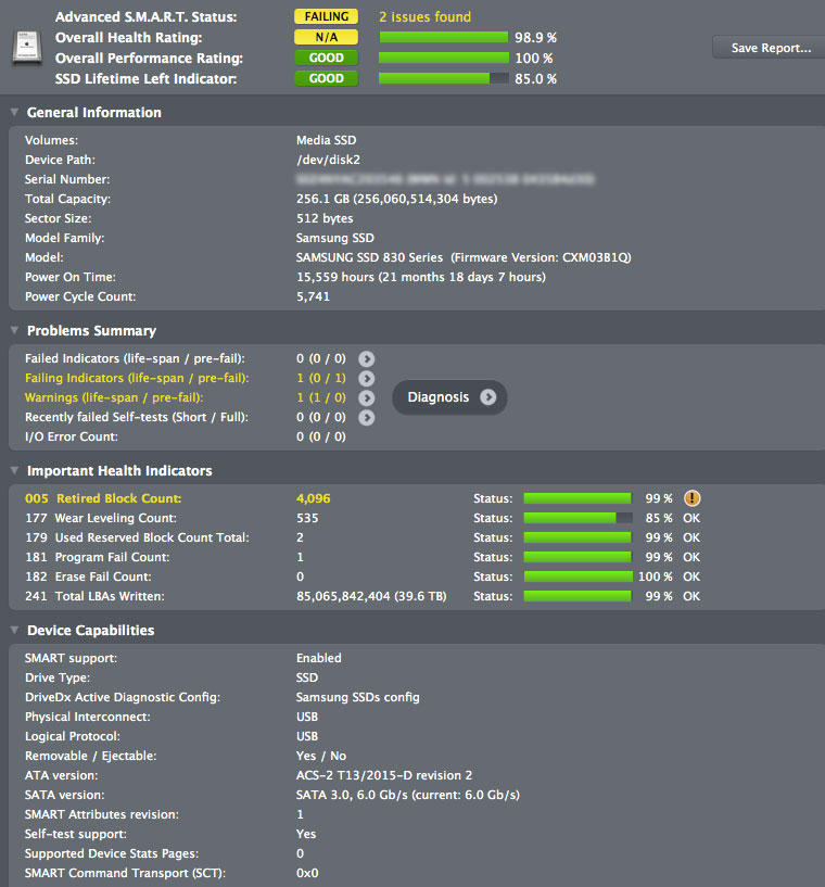

Hi, had a random "disk eject" on my cMP 2012. It's a Samsung SSD 830 connected via SATA cable... it's not my boot drive. I ran Apple First Aid, it thinks the disk appears OK. Ran a SMART test, it thinks it is failing [see attachment].
How do things look to you guys? Looks like I lost one (text) file to corruption. I might have had it open in the background, and the file just shows gibberish now.

If SMART says your hard drive is dying, most likely it's correct.
Anyway, did you enable TRIM? Even 830 is a 2011 product, just 6 years life span seems still a bit short (unless you really use it hard).
poweron time not even 2 years according to SMART. bad luck.
edit : and why almost 6000 power cycles? something odd in there.

His screen capture also suggested that it's actually connected via a USB cable. Most likely this is the reason why it has high power cycles, and no TRIM support (which makes the cells wear out much quicker than normal).
Make sure you clone your data to another drive ASAP. SMART has correctly reported pending drive failures several times for clients and they always call me when they see the "error". Basically have them run Carbon Copy Cloner to a standard external hard drive and replace the SSD within the next several days.

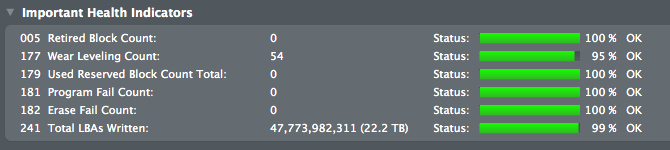

Screenshots from DriveDx from my two oldest Samsung 840 SSDs show much less wear. Both with 10,000+ hours of power on time and with 2,000+ Power Cycle Count.

It’s not a USB cable, just a SATA extension cable. I’ve been migrating data around, so I just use a SATA cable since it’s much faster when I need to transfer a lot of data and to swap disks. I also mentioned it since other threads mention cables as a source of failure.

Retired block count of 4,096? If I'm reading that right, that means that SSD has run out of spare blocks to assign to data from failed blocks.. so the drive can no longer compensate for its cells dying, if that were me I'd back up everything and just get a new SSD.
MicroCenter has the 500 GB 860 on sale for $84, you can get an Inland 500 GB for $65.. NewEgg has 500 GB Crucials for $100.. just get a new one..

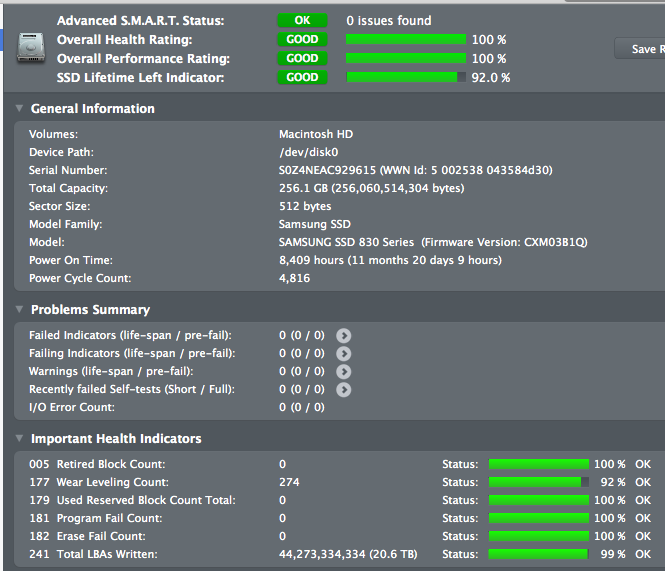

In the area of commentary, that drive has really been put through the wringer. I have the exact same drive, also installed in 2012, and heck of a lot less erase cycles to it.
